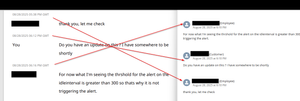

I am trying to gather information on technical requests that have taken a considerable amount of time to resolve. While doing so, I noticed when opening a ticket with technical support (through a chat conversation), the case record shows all conversation entries at the exact same time. It appears that the date/time stamp is for the last entry in the conversation. However, if you export the chat, the timestamps appear correct: I am curious if this information is relied upon in order to identify support improvements.SolvedJRider4 months agoNeophyte51Views0likes1Comment
