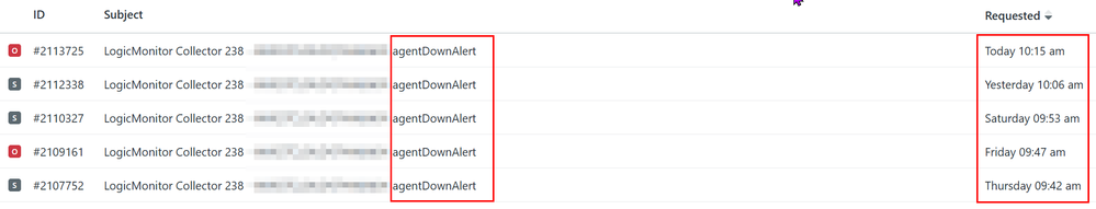

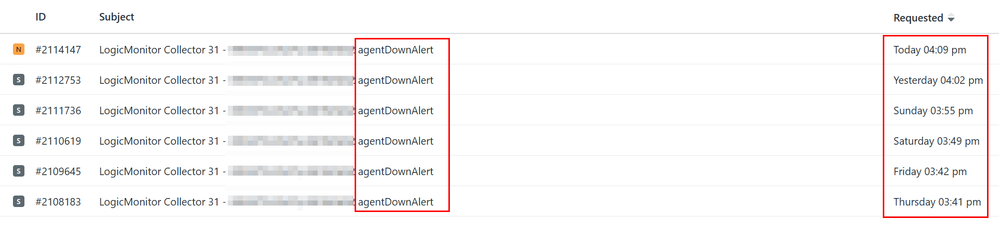

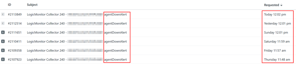

These are the tickets that they generated showing that it delays a few minutes each day, but is happening almost by clockwork.
I opened a ticket via Chat but was told that something is overload the agent and we need to up the collectors sizes.  This doesn't really tell what happened last Thursday that started causing the problem so I'm posting here wondering if anyone is having the same issue.
