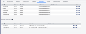

I'm by no means a guru when it comes to groovy or infix/rpn but I can't for the life of me create the Complex Datapoint I want. Here are the items collected by my DataSource. The Complex Datapoint I cant get working is the AutoHeal trigger. I've tried to use AI to help me build a query in the correct format, but none seem to work property and the documentation is pretty light on examples. Here is what I'm trying to do in a nutshell. If the 1_AutoStart value comes back as 1, and the 3_LatestState is not a 1, and the 2_RunningCount is less than 90% of 0_SampleCount, throw a 1, else throw a 0. Here is the current AI generated groovy code to try and accomplish this, but I get NoData with it. I've tried many different sample codes for both groofy and infix/rpn with no success. It doesn't like the "lt" in the GUI on many of the code samples, but accepts this one. if(1_AutoStart==1, if(4_AutoHealService==1, if(3_LatestState!=1, if(2_RunningCount/0_SampleCount<1, 1, 0), 0), 0), 0) Here is the GUI error when I try AI generated RPN code. Any thoughts or suggestions?38Views0likes1CommentCan token values be evaluated in a complex datapoint?
