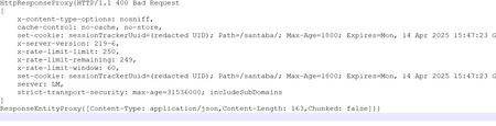

I have a user suspension script that I prefer to run instead of using the "Suspend user after X days of inactivity on LM portal" option in the UI, because of some custom logic. I set up a script ages ago and havent touched the code, but recently on a subset of users, I get a Bad Request (400) error. But whats weird is that all I'm doing is using /setting/admins/ with ?changePassword=false&validationOnly=false and building a minimalistic patching map of the required fields from the model, plus status is set to "suspended". It used to work 100% of the time, but weirdly when I coded it, there were only 3 required fields in the model: roles, password, email. And of course I'd set status in my map, convert to json, do all the stuff, no problem. But I noticed it was failing recently (I never set up alerts on fails) and assumed it was failing 100% of the time at first, reviewed the model and noticed they added "username" as required also, so I added that, expecting it to work, it didnt, so I took that out. THEN I discovered that on some users the old code works, but unlike before, there is a subset that I get a Bad Request on, using the exact same code. No idea why. I also later discovered, when a user came up for suspension that ended up working, that "roles" is not actually required because I removed that for a bit doing some testing, had a real suspend happen to come up, and the code worked without the "required"(??!!) field of "roles" not being in my patch object. This is SUPER FRUSTRATING that the API can change, and that the required fields may or may not be required. :) I made a full "every field" export api to csv script to output every user, looking for something like a property or a setting or something in the raw data that might distinguish a user that the script runs on versus one it wont. Heck I even have logs of the same user that the script had suspended last year (user asked to be reinstated) and it doesnt work on them now. I almost suspect it has something to do with the password, since I havent seen any SSO users the script fails on, and I cant see those. But when I look at every single property that comes back with a GET on the users, I'll have 2 local accounts with the same external group that have nothing different on fields like enabling 2FA or EULA or even the roles they are in or view permissions, there are 35 or so fields ...and nothing stands out. Everything seems like it should work for one user that works for another in these cases. And yet .... Bad Request. Sometimes. Driving me wild over here. At this point I've literally got the original code in place (never committed any changes during testing) and sometimes it works, sometimes it doesnt, but used to be 100% success last year. Stumped. Oh here is an example of the error: I guess I'm not really expecting any silver bullets for this issue, but just on the off chance this is a known issue, I figured I would double check. I wish there were some change log to the Swagger docs. Maybe there is, I'm UI-challenged. If there were API update history changelogs then it might be worth it to pin down when this issue started. Thanks!82Views0likes3CommentsLogic.Monitor (Release Updates) - v7.0

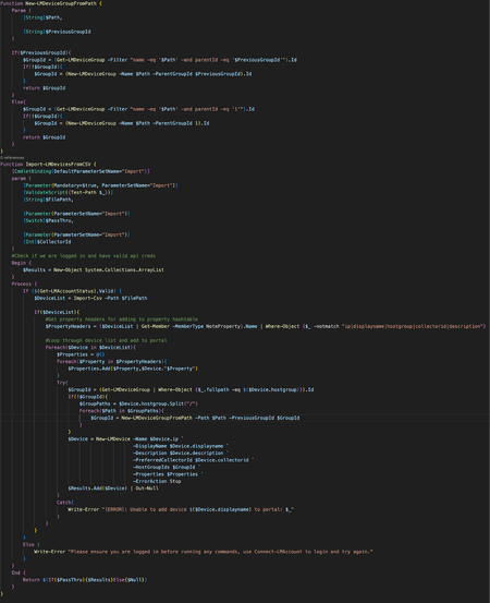

If you're a LogicMonitor user looking to streamline your workflows and automate repetitive tasks, you'll be pleased to know that there's is a PowerShell module available to help you do just that. As a longtime Windows administrator, I've relied on PowerShell as my go-to tool for automating and managing my infrastructure. I've found that the ability to automate tasks through PowerShell not only saves time, but also reduces errors and ensures consistency across the environment. Developed by myself originally as a personal side project, this module provides a range of cmdlets that can be used to interact with the LogicMonitor API, making it easier than ever to manage your monitoring setup directly from the command line. Whether you're looking to retrieve information about your monitored devices, update alert thresholds, or perform other administrative tasks, this module has you covered. In this post, we'll take a closer look at the features and capabilities of this module, and show you how to get started with using it in your own automation scripts. This project is published in the PowerShell Gallery at https://www.powershellgallery.com/packages/Logic.Monitor/. Installation From PowerShell Gallery: Install-Module -Name "Logic.Monitor" Upgrading: #New releases are published often, to ensure you have the latest version you can run: Update-Module -Name "Logic.Monitor" General Usage: Before you can use on module commands you will need to be connected to a LM portal. To connect your LM portal use the Connect-LMAccount command: Connect-LMAccount -AccessId "lm_access_id" -AccessKey "lm_access_key" -AccountName "lm_portal_prefix_name" Once connected you can then run an appropriate command, a full list of commands available can be found using: Get-Command -Module "Logic.Monitor" To disconnect from an account simply run the Disconnect-LMAccount command: Disconnect-LMAccount Examples: Most Get commands can pull info by id or name to allow for easier retrieval without needing to know the specific resource id. The name parameters in get commands can also accept wildcard values. Get list of devices: #Get all devices Get-LMDevice #Get device via id Get-LMDevice -Id 1 #Get device via hostname Get-LMDevice -Name device.example.com #Get device via displayname/wildcard Get-LMDevice -DisplayName "corp*" Modify a device: #Change device Name,DisplayName,Descrition,Link and set collector assignment Set-LMDevice -Id 1 -DisplayName "New Device Name" -NewName "device.example.com" -Description "Critical Device" -Link "http://device.example.com" -PreferredCollectorId 1 #Add/Update custom properties to a resource and disable alerting Set-LMDevice -Id 1 -Properties @{propname1="value1";propname2="value2"} -DisableAlerting $true ***Using the Name parameter to target a resource during a Set/Remove command will perform an initial get request for you automatically to retrieve the required id. When performing a large amount of changes using id is the preferred method to avoid excessive lookups and avoid any potential API throttling. Remove a device: #Remove device by hostname Remove-LMDevice -Name "device.example.com" -HardDelete $false Send a LM Log Message: Send-LMLogMessage -Message "Hello World!" -resourceMapping @{"system.displayname"="LM-COLL"} -Metadata @{"extra-data"="value";"extra-data2"="value2"} Add a new user to LogicMonitor: New-LMUser -RoleNames @("administrator") -Password "changeme" -FirstName John -LastName Doe -Email jdoe@example.com -Username jdoe@example.com -ForcePasswordChange $true -Phone "5558675309" There are over ~200 cmdlets exposed as part of this module and more are being added each week as I receive feedback internally and from customers. For more details and other examples/code snippets or to contribute you can visit the github repo where this is hosted. Source Repository: https://github.com/logicmonitor/lm-powershell-module Additional Documentation: https://logicmonitor.github.io/lm-powershell-module-docs/ Note: This PowerShell module is an open-source project created and maintained by LogicMonitor users. While not an official LogicMonitor product, it's designed by people who use and understand the platform. The module is freely available for everyone to use, modify, and improve. We welcome your feedback and contributions! If you have ideas or encounter any issues, please share them through GitHub issues or pull requests. Many community members rely on this module in their daily operations. Though we can't offer formal support guarantees, our collaborative community strives to address questions and continuously enhance functionality. We hope you find this tool valuable for your LogicMonitor workflows!3.6KViews55likes30CommentsHelp Needed: API to Move Discovered Instances of Device Data Source to Default Group
