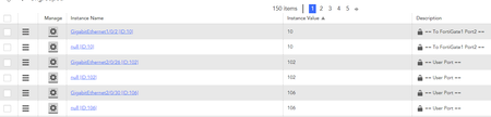

Is there any solution for when network interfaces get assigned a brand new ID or become null and have a duplicate ID? Example: This seems to have every so often across our clients where Ge1/0/2 will go from ID 10 to ID 150 randomly maybe after a firmware update or something. You would think LM would be smart enough to merge these togethers or not create a duplicate null ID 10 when it exists already. I guess I could filter out null instance names in the discovery but that doesn't resolve the ID change on interfaces.356Views6likes4CommentsExcluding VMware VMs from instance discovery
