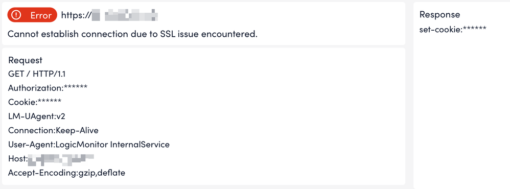

Then the website check step failing:
One other minor frustration is in the debug runner, !opssl is listed as a valid command, however when trying to run it, it says unknown debug command, really not all that useful so I can to connect to the customer environment and directly ssh to the collectors to even begin troubleshooting because there was no real useful information returned in the UI.
  • Just to close this one down, it seems there is an issue with TLS negotiation, so it's a 3rd party issue.
    LM support fed the following back:
    While both certificates are trusted and valid when accessed via a browser, the LogicMonitor collector's internal HTTP client is encountering a fatal TLS handshake error with the message: "Received fatal alert: protocol_version."
    We also ran !ssltest, which confirmed that the server advertises support for TLSv1.2 and that the certificate chain is valid. However, despite this, the collector is unable to complete the handshake due to an incompatibility in how the endpoint negotiates TLS during connection establishment. This can be caused by:
    • An unsupported or non-standard TLS handshake response
    • TLS header behavior that differs from RFC-compliant expectations
    • Cipher suite ordering or compatibility issues
