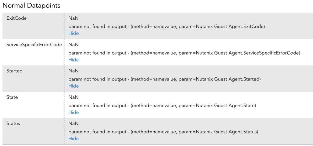

Hi everyone, very new to the community and the product so would love to get your feedback on this issue that I'm currently facing. I've got this custom datasource that is configured to capture critical windows services that are supposed to run but not running - I kinda edit from the original Windows Services datasource to fill our use case. The original works well but because of how much CPU/resources is pulling from, it's causing an issue for us. Thus why we are opting for a batchscript method rather than groovy so that it will less resource hungry.
The datasource is configured to run via embedded powershell and so far it has been working well but what I really cannot figure out is that there are a bunch of alerts for these services that flagged out but when I physically check the services in the VM, they are up and running. When I hit "Poll Now", I'm receiving these error. Can anyone who have the same issue, care to shed some light please.

OP2 years agoThank you both, Mike and Stuart for the input! I believe this has solved it. Much appreciated!

·2 years agoYes, it is odd that the poll now extracted it in the raw output, but it couldn't parse into datapoints because of the space.
LM User
·2 years agoWildvalue cannot contain spaces.

OP2 years agoHi Mike, thanks for getting back to me. Please see screenshot below.
Mike Moniz
·2 years agoInteresting, it looks like it pulled the output correctly. Can you provide the setting used for one of the Datapoints (other then ExitCode)? Are they set for "Content the script writes to the standard output", "multi-line key-value pairs" and "valid value range" boxes both empty?
Mike Moniz
·2 years agoCan you provide the bottom half of the poll now window? LM appears to be looking for the text "Nutanix Guest Agent.ExitCode=X" and not finding it. The Output and ##WILDVALUE## section of the Poll Now data would help determine that. A common cause is not putting ##WILDVALUE## in the datapoint when using BatchScript. For example you likely want to have "##WILDVALUE##.ExitCode" for the ExitCode datapoint... But that wouldn't explain if this is sometimes working and sometimes not. Also perhaps you are hitting the limit of text that LM will parse in the output?
