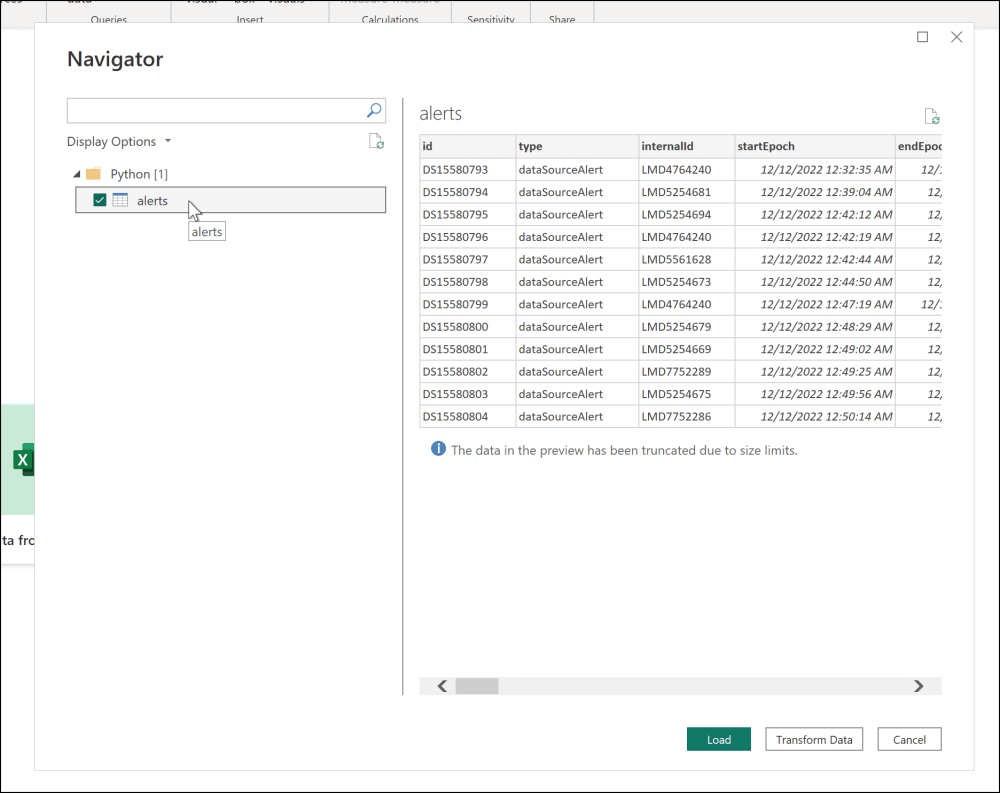

- When it's complete, you'll see the Navigator pane with the name of the Python Pandas dataframe from the script output. Check the box next to the item to see the data preview. If the sample looks good then click the Load button.

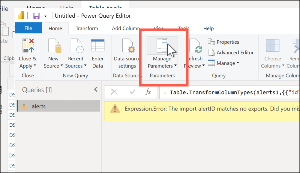

- With the report active that we want to turn into a template, click the Model icon to the left of the workspace. From there, click the three dots in the upper-right corner of the table generated by the Python script and choose Edit Query.
- That will open the Power Query Editor. From here click Manage Parameters on the toolbar.
- For our example we'll add three new parameters, which we'll call "AlertID", "AlertKey" & "PortalName" (feel free to label them however you choose). For each, enter the respective criterion used for accessing your LogicMonitor API in the Current Value field. Below's an example of what it would look like when completed. When done click the OK button to close the dialog.

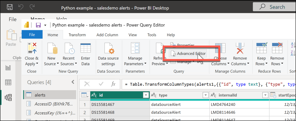

- Next, click the table name in the Queries list ("alerts" in our example screenshot) and click the Advanced Editor option in the toolbar.
- You'll see Power BI’s M language query for our datasource, including the Python script embedded in it. We're going to edit the script to replace the hard-coded API parameters to use the Power BI parameters we defined instead. Replace the values of the script's AccessId, AccessKey, and Company variables with the following, respectively (including the quotes):
" & AccessID & "
" & AccessKey & "
" & PortalName & "
Note that those will be inside the single quotes for each of the variables. Refer to the screenshot below for an example of how it would look (the changes have been highlighted). When ready click the Done button.
