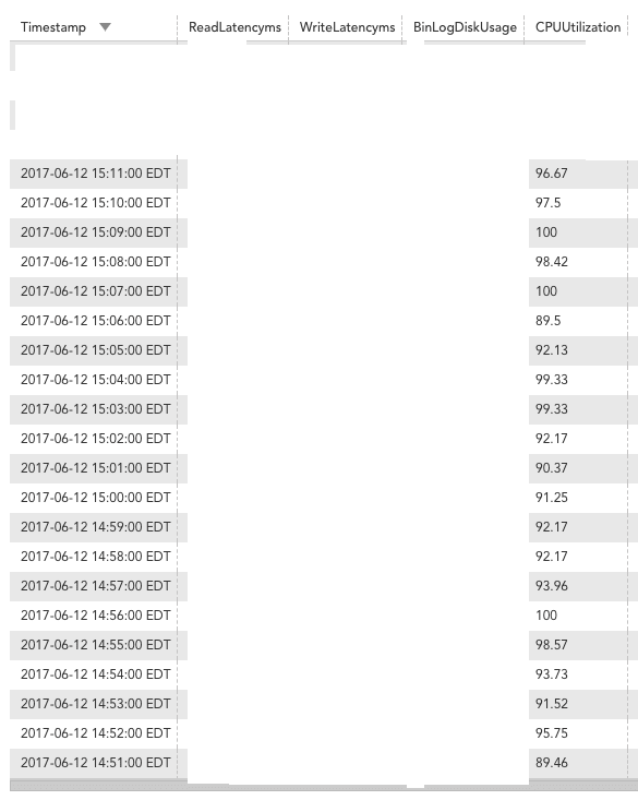

Next, once you determined the alert source, you need to understand why this alert is triggered. This can be done by first looking at the threshold that is set for that particular datapoint. After checking the threshold you can go to the raw data tab of the datapoint to check if it meets the threshold being sent.
For example
In this case, a critical alert was received and a threshold of 80 90 95 and an alert will only be triggered if you have 20 consecutive polls that fall within this range. Now the next step would be to check on the RAW DATA tab to determine if this condition was met.
Judging from the raw data above if you look at the values all the 20 polls have met the threshold level of 80 90 95, but to determine the level of the alert it would be the last poll since the last poll was 96.67 will falls to the range of a critical alert thus a critical alert was send.
