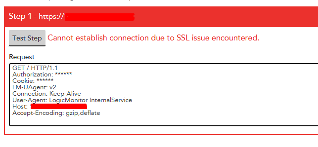

LogicMonitor is telling me that one of my FortiGate firewalls, which uses a self signed cert for the GUI, is giving a couple of errors.  One error was "days remaining" for the SSL certificate and the other is just this generic "SSLError".  I went into the FortiGate and renewed the self signed cert for the GUI and that cleared up the "days remaining" error but the generic "SSLError" persists.  I'm not quite sure what's throwing the error so I'm not really sure what to do to resolve it.  Suggestions?

        I did find this in the wrapper log.  Not sure it's helpful or not?
        [FSMWebpageTask$HttpResponseCallback.failed:958] Caught SSL exception, CONTEXT=host=<IP>, sslErrorReason=unknown., EXCEPTION=javax.net.ssl.SSLProtocolException: The size of the handshake message (37037) exceeds the maximum allowed size (32768)
        I'm not sure how one would adjust the size of the handshake message or how it got wonky to begin with... or if it's just a red herring?
