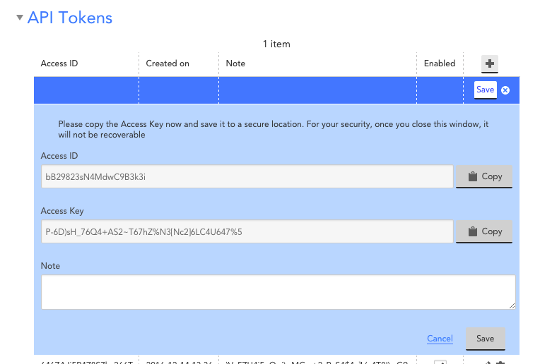

This is the authentication setup.  It’s easier than it looks.
To get the AccessID and AccessKey, open the console and create a new or use an existing user.  Under the API Tokens, press the + button to generate the tokens.
xyjTF1syOOwGcHYkI0IOIVM2HJtIt51L__vngQjjyz1VCvch3eAgmBhMHSN90iZR0nnfIJUHlqmUo3AIdNzSJzOZbvkMz5Dgaj0mfhF4vRyvrQoOooZbfZEJGSyN0tCTwqeB-6ss
The company name is the portal  ie, mine is ‘lmjeffwoeber.logicmonitor.com’ so my company is 'lmjeffwoeber'
#Account Info
AccessId ='bB29823sN4MdwC9B3k3i'
AccessKey ='P-6D)xH_76Q4+AS2-T67hZ%N3|Nc2]6LC4U647%5'
Company = 'lmjeffwoeber'
