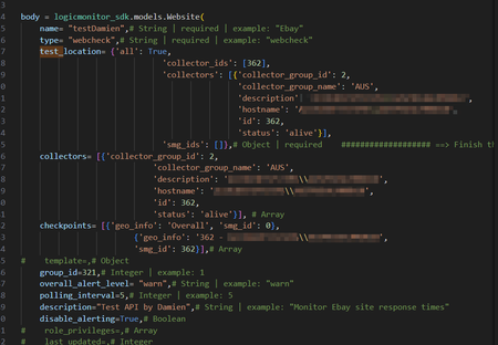

DamienC- did you get this working yet?
Is the collector you're trying to use actually dead? It's possible it's not allowing you to add dead collectors as your test location.
I checked my code again. I only include test_location, but i noticed there's a `is_internal` flag. Ae you setting that to true?
- DamienC1 year ago
Neophyte
Thanks for taking the time to reply, I really appreciate.
My code does include the "is internal" boolean.
The collectors I'm using are working. I tried a few differents, just to rule that out.These were good advices, thank you.
If anyone else sees something else, feel free to participate :DToo bad LM support considers this as "custom" work and won't help. To me, creating a webcheck is fairly standard work, no matter if it's through an API or the GUI.
