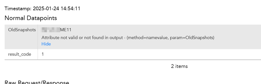

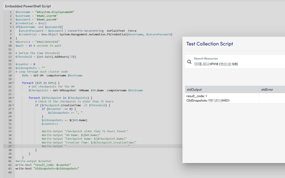

I'm trying to write a DS to return how many Hyper-V Snapshots I have that are more than 3 days old.  The script works but I'm having trouble returning the data.
Here's the script and the output it's showing:
What I want to get is the number 1 in the result column and the name of the VMs with Old Snapshots in the OldSnapshots column.  I've tried various options for the Interpret output with and other settings but can't get it to work.
Sometimes it looks like it works, but still shows an error.  Then it will have NoData in the Raw Data area.  Is it because it's text and not a number?
I'm just spinning my wheels at this point so any help would be great.
Thanks.

  • Yeah, Datapoints can only be numbers. You can't have text in it.
    For the case where you want to report which VMs have old snapshots. You can might be able to make the VMs into instances and each report it's snapshot age.
    I also don't suggest you code thresholds into the code directly, just report the age in hr (or min or days) and use LM to set thresholds. That way you can have overrides and exceptions.
