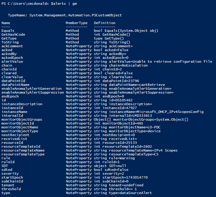

Has anyone figured out how to get at the ##ExternalTicketID## programatically at all?  Not having access to that is driving me to distraction.  It's in the DB somewhere, but we can't get to it to help automate our workflows and toolsets.
Right now, I'm troubleshooting our Connectwise Integration and have to manually relate 4637 integration log entries to tickets manually one by one.
Only having this internal var being able to be exposed in the Alerts view is hobbling our ability to build and troubleshoot our integrated systems.

      Still no return.  Here's the full (nearly) RestAPI URL I'm using:
      ********.logicmonitor.com/santaba/rest/alert/alerts?customColumns=%23%23EXTERNALTICKETID%23%23&size=1000&offset=0
      I get a full return of alerts, filter to ones that would have ticketed in connectwise and should have an EXTERNALTICKETID value present.  There is no extra property returned in any of them
  • I am passing the x-version=3... let me comment that out and see if it grabs that data for me.
    That returns nothing.  Are you passing a different value for the version?
