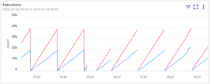

We're having some difficulties getting the Unifi 'Sources to properly complete their Active Discovery Scripts, leading to building thread counts in the collector, leading to collector service restarts...
(ScriptADTasks - 7 days - Red = Failures):

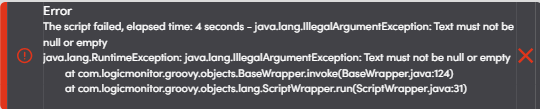

Running AD Test from the DS "Ubiquiti_UniFi_Security_Gateways" against a UXG Pro device gives me this error: "Text must not be null or empty"
It doesn't identify which text is needed.  The line numbers mentioned don't seem to relate directly to the DS AD code's line numbers.

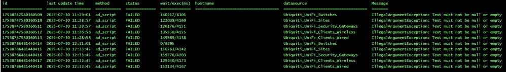

  • Here's the !ADLIST from the collector showing the full list of DS and the response from them:
    No indication what text is null or empty for me to troubleshoot.  Setting the debug flag to true doesn't produce any useful results in the code.
