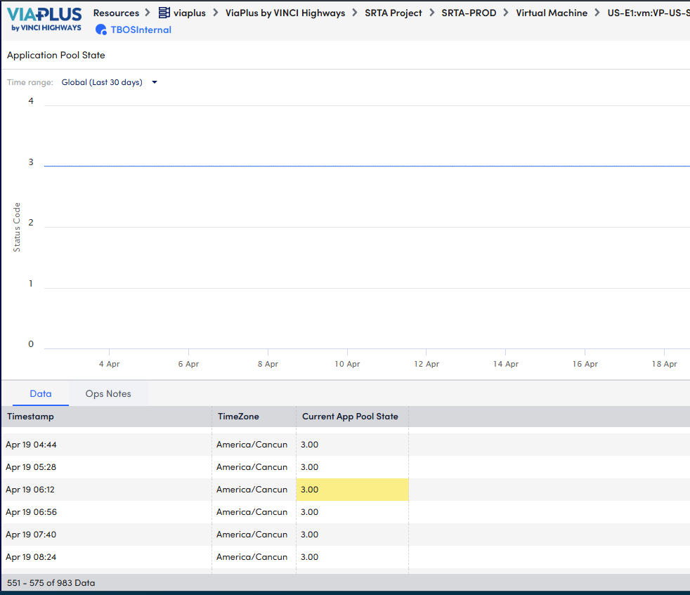

How can I get more 'Raw Data' out of LM? When I go to a graph to get the data it uses I can see the Raw Data for the time interval specified.  But it only goes back for 500 records; which for data every 4 mins is less than a day and a half....I need a month.  How can I extend it?

  • You can use the Graph tab (or create a graph on a dashboard) that contains the data you want. View the graph full screen (square icon) and change the range to what you would like. It will show a table of the data under the graph. You can also click on the download icon to get a CSV of the data.
  • I see what you're saying.  However, the interval data in the table is every 45 mins.  My client wants the interval to be 3-4 mins.
