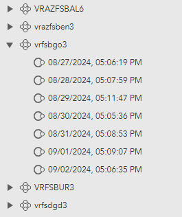

Azure Backup Job DS Discovery
We have a problem with the Azure Backup Job DS only doing discovery once every 7 days. Im interested to know if anyone else has seen this ?  So looks like discovery ran on the 02/09 today is the 05/...
  • Barb's avatar
    Barb
    12 months ago
    I have found the issue. I had changed the AD instance level property to auto.properties.backupmanagementtype
    Which makes more sense. I changed it at least a year ago and it was working but recently it has obviously stopped working, which is a shame. When you told me you weren't seeing any issues i knew it must have been this customization, set it back to auto.properties.backupmanagementtype and all working. Thank you for your help guys :)
    Thanks
    Barb
