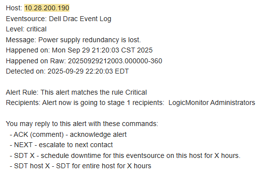

  1. Massive Alert Delay: The initial power loss events occurred and were resolved around 7:00 PM and 8:00 PM (based on the Lifecycle Log). However, we started getting a huge flood of critical alerts via email at 9:13 PM, 9:43 PM, 10:13 PM, and 10:43 PM—hours after the issue had been mitigated and redundancy was restored.
  2. Excessive Alert Volume: We received dozens of separate critical alerts (e.g., LME205086576, LME205086578, etc.) for a single, contained event, all arriving en masse hours later.

  • LogicMonitor Email Log (Image 1): Shows critical alerts arriving long after the issue was resolved (9:13 PM to 10:43 PM).

  • Could you share what type of alert it is, Ping, SNMP or WMI, along with an example alert and the thresholds set at the folder, device, or module level?
  • I guess that SNMP IDRAC LOG it de snot seem to happen all the time.
