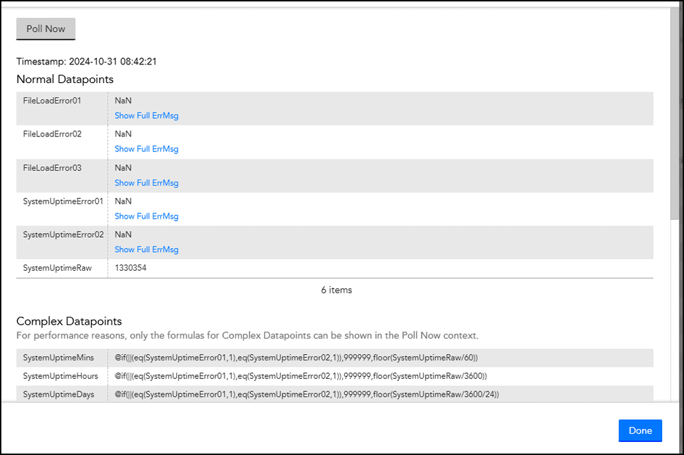

OP1 year agoNow it is back to non-existent list file in Collection, and here is the expanded ErrMsg from Poll Now window (I blacked out the FQDN but note that there is a dot separating the FQDN and datapoint name FileLoadError01, and it's a standard FQDN with no spaces or anything, just <servername>.<subdomain>.<ourdomain.edu>). FileLoadError01=1, and we see this in the "Test Collection Script" output.
The exact same setup works fine for triggering the SystemUptimeError01 datapoint when it's iterating through the list and fails at something, the only difference here is that in this case (although all instances are there in Active Discovery from the in-script list), there's no list to iterate through because it checks for File Not Found (and doesn't find one in this case) before proceeding, and if so, writes that key-value pair to the FileLoadError01 datapoint and exits. That expanded ErrMsg about Param not found is also what you see in any datapoint column when it really SHOULD be showing NoData and correctly not reporting or triggering.

·1 year agoCan you show the bottom half of the Poll Now window? That should show the data it got along which what it attempted to pull.
The error message says it can't find the line that matches xxxxx.FileLoadError01=#. In the Poll Now window try to copy the param (the xxxxx.FileLoadError01 thing) to the clipboard, then paste it into the in-page search in the browser to see if it shows up exactly char-for-char in the bottom half of the Poll Now, in the output section. If it does show it there but LM is still not pulling it in, you may need to work with LM support to look at your specific datasource in your portal.

OP1 year agoAnd here is the Poll Now on that same page:
Mike Moniz
·1 year agoYou can also click on the "Show Full ErrMsg" link to see what it says caused the NaN/NoData.

·1 year agoClick on the "Poll Now" button and grab a screenshot of that, especially the bottom half as it will show what it pulled and what it's looking for.

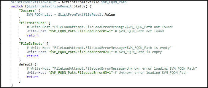

OP1 year agoI cleaned the textfile path reference up before using Write-Host, and as before, it shows exactly what you would expect in "Test Collection Script" for File Not found: the same key-value pair as above in the code box, but this time with a cleaned (but fictitious) path. Still, even though the output targets the standard datapoint FileError01 with a value of 1, and you can see it when testing the Collection script, by the time it's listed in the Raw Data polling results for any of the instances (for now I'm using the in-script list for Active Discovery to remove any consideration of File Not Found in AD), it doesn't show 1 in the FileLoadError01 column, but NoData.
I'm basically back to being stumped as to why one works that way and the other doesn't.

·1 year agoCan you take a screenshot of running Poll Now of that DataSource under the device on the Resource page? That might give a better clue what LM is attempting to do.
SteveDahlberg
OP1 year agoThat was it - exit 1, rather than return 1. Works as you described, and same with just displaying the error string.

But, I can't seem to make it work, so far anyway. In the section where it has determined it can't locate the file at that path, if I can't write to one of my error-handling datapoints here when it's running for Active Discovery (that was my first thought, then I figured you can't do that, and you confirmed it in your last response), instead of the normal WILDVALUE##WILDALIAS Write-Host, I was returning the strings you see below. That way at least there's an instance for the error (with those as its name), indicating something's wrong. And I changed "return" to "return 1". But it was still removing all the instances. So I thought maybe I should populate nothing into the WILD tokens while returning 1, but it still deleted all the instances. I really hope I'm missing something easy here, because I think this would be the easy solution!

·1 year agoYou can try "Exit 1" instead of "Return 1" to make sure it's exiting the whole script with exitcode 1. https://www.logicmonitor.com/support/logicmodules/datasources/active-discovery/script-active-discovery
"If the script output is empty or malformed, but the script exits with a code of 0, all previously discovered instances will be removed. To prevent Active Discovery from removing instances in the case of a script error (such as an SNMP timeout), make sure your code is designed to catch such conditions and return a non-zero exit code."
Also you can still write-host before exiting, but you don't need to try to format the error message using x##xxxx##xx and just output the error message straight. LM shouldn't be attempting to interpret it unless you exitcode 0 (or no exitcode) You would only see it when using the test button anyway.

OP1 year agoMike, Yeah, the textfile is on one of our Collector servers, and that is what we're using to monitor. Keep in mind, this all works fine in a PS session on the Collector server, it finds the local path, it all works. Just not in LogicMonitor, here are some screenshots below. In this case, the actual test of the textfile path and determination of the result happens in a function that attempts to find and read the contents of the file (a simple list of text, one per line). It's called from the main loop and passed the (previously-assigned) value of:
$VM_FQDN_Path = 'C:\JCCC-Local_Text_Files\LM_FQDN-VM_list.txt'
Here a screenshots (in order) of the function that attempts to read the textfile and load its contents, that function being called from the main script and the corresponding output (using Write-Host), and finally, the results in LogicMonitor from using Test Script on the Collection script:

·1 year agoShouldn't need to do anything special to reference local system. I'm not able to replicate the issue myself. Can you get a screenshot of a minimum script and Test output like my working test below?
Mike Moniz
·1 year agoI'm not clear where the text file you want to pull is. Is the file on the server running the collector software or on a different system?
Scripts will always run from the collector. So if the file is in another system, you would need to write your script to have it connect and pull the file. That might be using something like \\server\c$ or doing a Invoke-Command to run powershell commands on the remote system.
If it is local to the collector server, what does the Test Button/Poll Now show? What kinda LM script is this? Part of a ConfigSource? DataSource?
SteveDahlberg
OP1 year agoI believe most of that is answered in my post. But to be clear, the .txt textfile is (for now anyway) at the absolute path "C:\JCCC-Local_Text_Files\my_testfile.txt" on one of our collector servers where I've been developing the script. It works fine from a PowerShell session on the collector server. But so far, I can't get it to see the file (so I can read from it in the script, like I do when the same script runs in PS session on the collector server). This is in a DataSource.
I use `Test-Path $textFilePath` in the script to make sure it's there, works fine, but when running embedded in LM, it always reports that it can't find it at that absolute path location. I even tried copying it to "C:\Program Files\LogicMonitor\Agent\bin\JCCC-Local_Text_Files" but that didn't work, then I tried just the text file itself at that location (rather than the containing folder), but no joy. The LogicMonitor service account is in the local admins group on this Windows server, and has "Full Control" explicitly granted on the folder in question, although it shouldn't need it I wouldn't think.
I'm relatively new to this, and it feels like I'm missing the proper way to refer to the local filesystem (if it's different than what I showed above with Test-Path above. I'm totally stuck.
