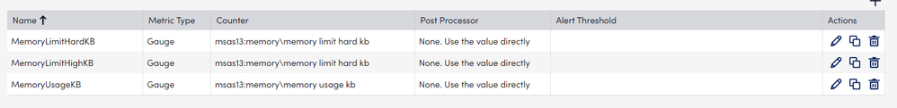

Data I am polling through the data source's collection method ( PERFMON) For SQL server Analysis service memory metrics
Below are the data points I have created.

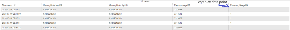

Now Upon This I have created one complex datapoint for the condition
(if 'Memory Usage KB is greater or equal to 'Memory Limit Hard KB, then trigger alert)
By using Infix expression I achieved this.
if(gt(MemoryUsageKB,MemoryLimitHardKB)1,0)
But instead of returning 0 (since this is false ) it's returning 1 (as true)
The expression if(gt(MemoryUsageKB,MemoryLimitHardKB),1,0) should return 0 when MemoryUsageKB (3298832) is less than MemoryLimitHardKB (132120162). Given the values you provided, let's break it down:
Comparison: gt(MemoryUsageKB,MemoryLimitHardKB) translates to gt(3298832, 132120162).
Evaluation: Since 3298832 is not greater than 132120162, gt returns false.
Result: The if statement should return 0 because the condition is false. which is not)))

I'd like to see a screenshot if your infix expression. Is it possible the two terms of the gt() function are in the wrong order? What happens if you plug in raw values instead of variables into the complex datapoint? Does it still return the wrong value?
