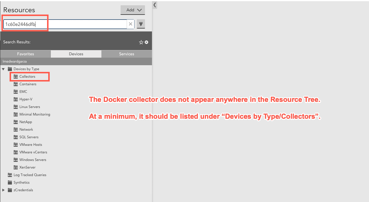

- The collector is not listed anywhere in the Resource Tree, including “Devices by Type/Collectors”.

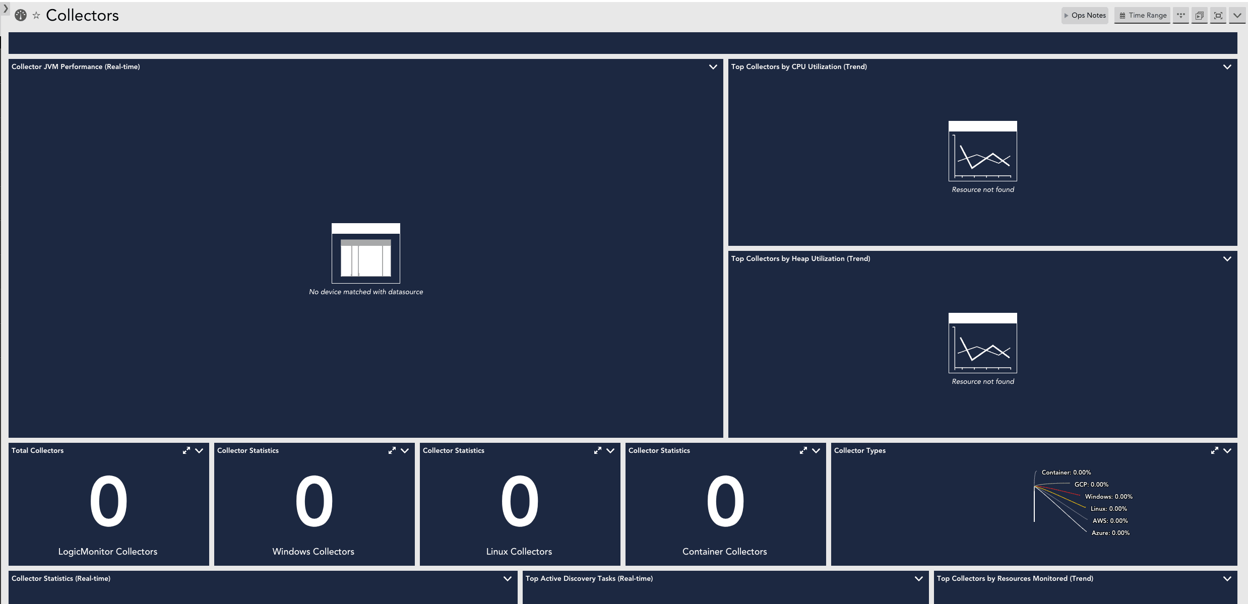

- If you look at the “Collectors” dashboard, the collector container metrics are not present.

Screenshot Showing Docker Collector Nowhere to be Found in Resource Tree
Screenshot Showing Missing Docker Collector Metrics in “Collectors” Dashboard

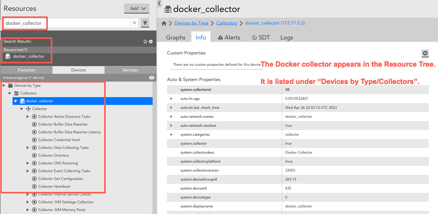

- Resolve item 5 by linking the Collector “Device Name” to the monitored Docker container resource
- Resolve item 7 by adding the Docker container to the Resource Tree and “Devices by Type/Collectors” group

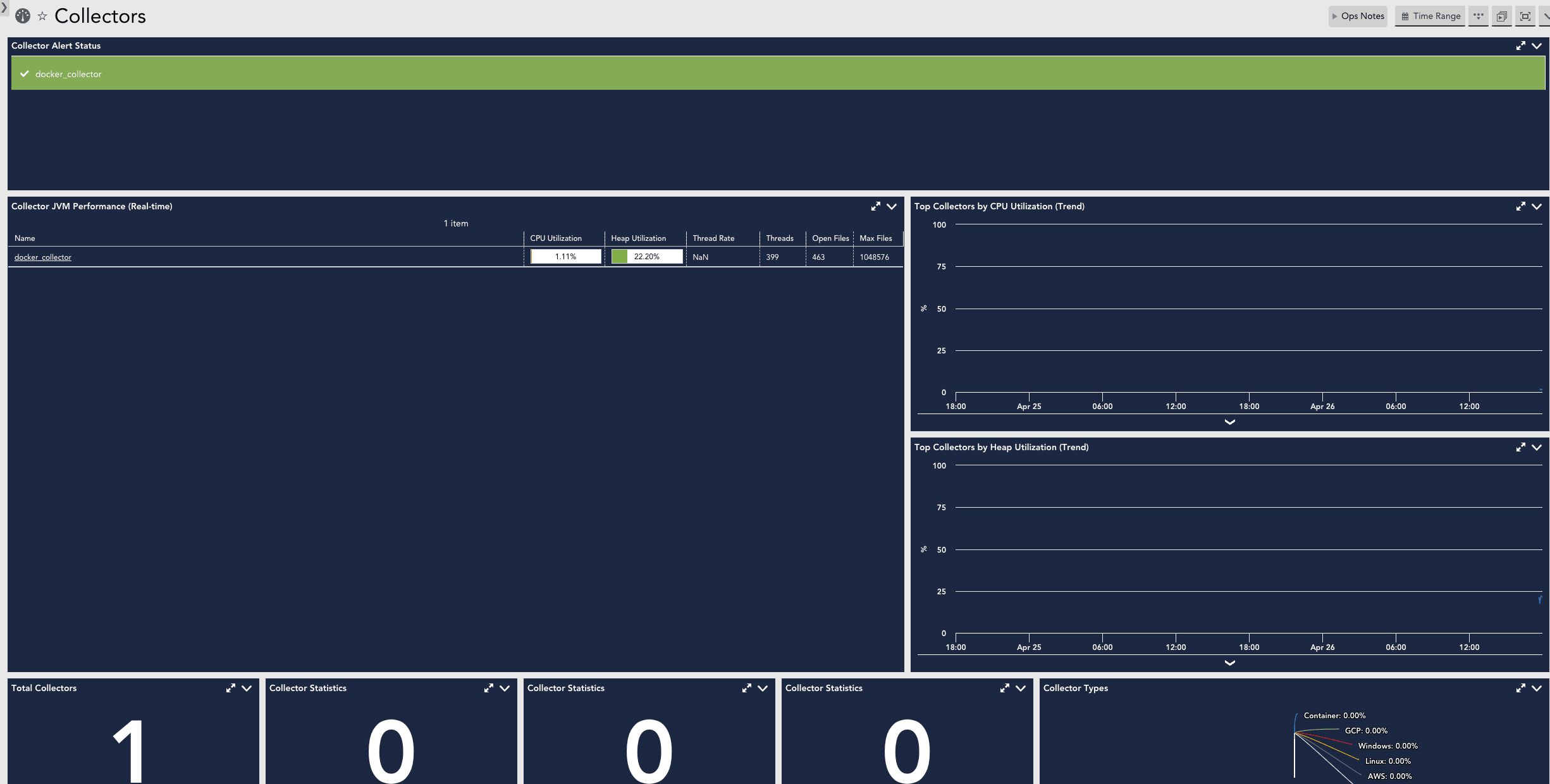

- Resolve item 8 as the “Collector” datasources will be applied to the monitored Docker container and the metrics will be displayed in the Collectors dashboard
Screenshot Showing the Docker Collector Linked to a Resource
Screenshot Showing Docker Collector in Resource Tree
Screenshot Showing Docker Collector Metrics in “Collectors” Dashboard
