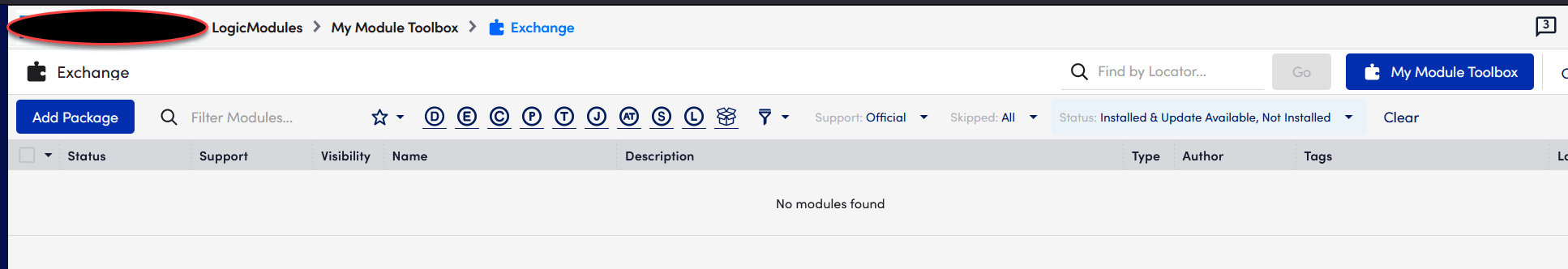

So we recently received a banner in one of our portals stating that in a future release the LogicModules section will no longer be available. This concerns us greatly as I noticed something after I just had a new portal spun up. I logged in, went to the Modules section in the new UI and told it to show me all of our outdated items. Nothing shows up. I then went into the Exchange, told it to show me all of the Installed and Update Available. Nothing shows. I also checked for anything Official that isn’t installed, and nothing shows up. So I naturally go the legacy route, load up DataSources, and tell it to look at the repository. Lo and behold, I have 85 DataSources. Some are new, some are updated.
We were told at one point that the Modules/Toolbox/Exchange area look at a different repository, so we gave the benefit of the doubt and checked one of the new modules and an updated module, and both were 3 months old and not showing up in the new UI.

·2 years agoHi @Joe Williams, did you have the proper filters enabled in Module Toolbox to return all the desired results?
Here is what it is looks like.
Definitely looks good from what I can see.
The short story is that this is still in development. The great part about the story is that comments like this help our authors (Developers) get closer to a wholesome final chapter.
It may never be perfect, but the idea is to get better everyday.

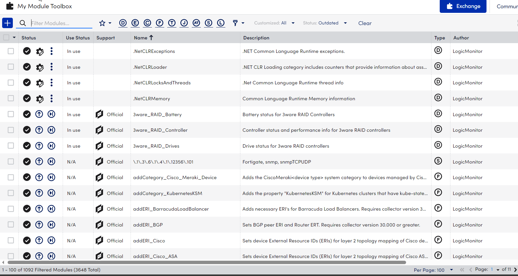

Joe Williams
OP2 years agoHi @Joe Williams, did you have the proper filters enabled in Module Toolbox to return all the desired results?
Kwame Armstrong
