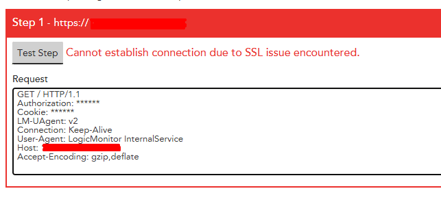

Kirby Timm
OP1 year agoInternal web check doesn't give any more useful information
