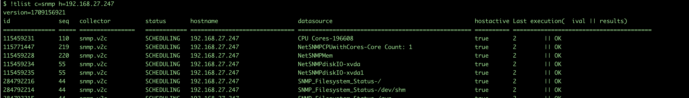

For your testing though, the easiest way to see how the change goes is to use the collector debug facility (only available to administrators with the proper role) to see how long the execution tends to take on a resource or a few resources, make your changes, wait for a new set of polls, and then check again.
Here’s a screenshot of a lab collector’s response to a !tlist command with filter arguments for SNMP collection and a particular resource. The execution time and status are the two rightmost columns. (Note that SNMP is fast ~ 2 ms here)
