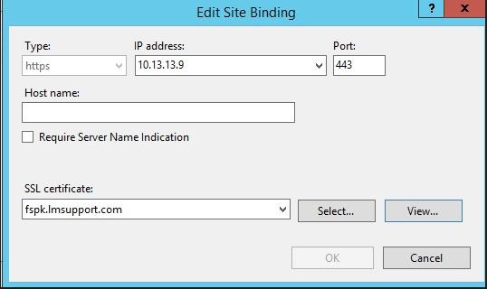

1) For a start is to check if the SSL certificate configuration is properly done in the web server
- Each web server may have a different way of setting up the certificate, the following is an example for NGINX & IIS:
- An open port check would be good as well with below output from the check (note: port is bound to any interfaces or possibly only one interface on the web server):

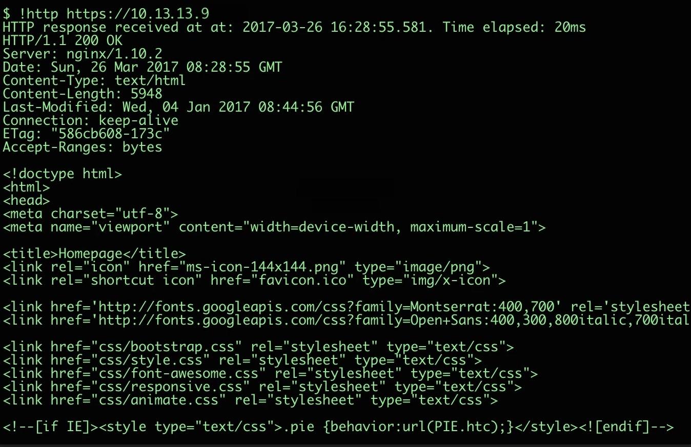

2) The next check will be to access the web server from the collector (obviously the collector must be able to reach to the device where the web server is installed):
Note: Collector debug window is needed for this check, please refer to this article: https://www.logicmonitor.com/support/settings/collectors/using-the-collector-debug-facility/
- the main command is simply: !http (help !http will give info for the command itself)
<span class="pln">$ </span><span class="pun">!</span><span class="pln">http https</span><span class="pun">:</span><span class="com">//10.13.13.9</span><span class="pln">
HTTP response received at at</span><span class="pun">:</span><span class="pln"> </span><span class="lit">2017</span><span class="pun">-</span><span class="lit">03</span><span class="pun">-</span><span class="lit">26</span><span class="pln"> </span><span class="lit">16</span><span class="pun">:</span><span class="lit">28</span><span class="pun">:</span><span class="lit">55.581</span><span class="pun">.</span><span class="pln"> </span><span>Time</span><span class="pln"> elapsed</span><span class="pun">:</span><span class="pln"> </span><span class="lit">20ms</span><span class="pln">
HTTP</span><span class="pun">/</span><span class="lit">1.1</span><span class="pln"> </span><span class="lit">200</span><span class="pln"> OK
</span><span>Server</span><span class="pun">:</span><span class="pln"> nginx</span><span class="pun">/</span><span class="lit">1.10</span><span class="pun">.</span><span class="lit">2</span><span class="pln">
</span><span>Date</span><span class="pun">:</span><span class="pln"> </span><span>Sun</span><span class="pun">,</span><span class="pln"> </span><span class="lit">26</span><span class="pln"> </span><span>Mar</span><span class="pln"> </span><span class="lit">2017</span><span class="pln"> </span><span class="lit">08</span><span class="pun">:</span><span class="lit">28</span><span class="pun">:</span><span class="lit">55</span><span class="pln"> GMT
</span><span>Content</span><span class="pun">-</span><span>Type</span><span class="pun">:</span><span class="pln"> text</span><span class="pun">/</span><span class="pln">html
</span><span>Content</span><span class="pun">-</span><span>Length</span><span class="pun">:</span><span class="pln"> </span><span class="lit">5948</span><span class="pln">
</span><span>Last</span><span class="pun">-</span><span>Modified</span><span class="pun">:</span><span class="pln"> </span><span>Wed</span><span class="pun">,</span><span class="pln"> </span><span class="lit">04</span><span class="pln"> </span><span>Jan</span><span class="pln"> </span><span class="lit">2017</span><span class="pln"> </span><span class="lit">08</span><span class="pun">:</span><span class="lit">44</span><span class="pun">:</span><span class="lit">56</span><span class="pln"> GMT
</span><span>Connection</span><span class="pun">:</span><span class="pln"> keep</span><span class="pun">-</span><span class="pln">alive
</span><span>ETag</span><span class="pun">:</span><span class="pln"> </span><span class="str">"586cb608-173c"</span><span class="pln">
</span><span>Accept</span><span class="pun">-</span><span>Ranges</span><span class="pun">:</span><span class="pln"> bytes</span>It shows that the web server is accessible at port 443 (HTTPS) with response code 200 as follows:

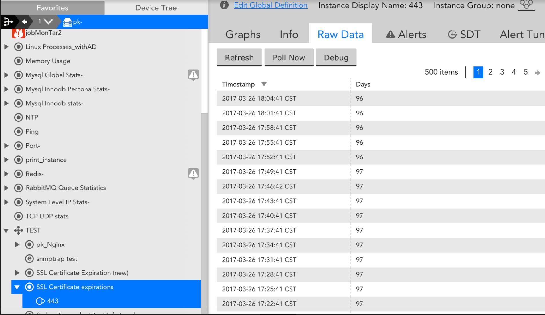

Having gone through all the above-mentioned checks and the results are good, it will produce this monitoring in LogicMonitor as follows:
