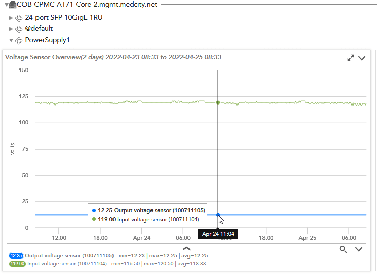

I have upload a picture of both one that shows good values and one that shows bad values.

·4 years agoI'm not seeing a max on the datapoint definition nor on the axis in any of the graph definitions. Normally, if you don't set a max, it just auto adjusts to a decent height so everything is visible on the graph. You can hard code that, or leave it automatic.

OP4 years agoOK - thanks for helping me understand the process. I see that I also have the ability to set the alert.
As an aside -
I noticed that the allowed ranges were 0 to 207 volts. - - I'm seeing actual voltage values higher than 207 though - it is a 240 volt source.
In rolling through the devices - I see some at 210 for instance.

Voltage Sensor Overview <- this is an "overview" graph, meaning that it shows data from all sensors on the device. In this case, one line per instance.
Volts <- this is technically the overview graph datapoint name, which in this case is the same as the datasource's datapoint name.
As I understand your ask: you want to put a custom threshold on the volts datapoint, but only have that threshold apply to instances where the instance group starts with "PowerSupply". There may be other sensors, but they may not be in an instance group called "PowerSupply" and you don't want those sensors to generate an alert when the voltage is 0. Is that correct?

Within that is then the Voltage Sensor Overiew which has the Input Voltage Sensor (100711104) Volts and Status - -I want Volts.
