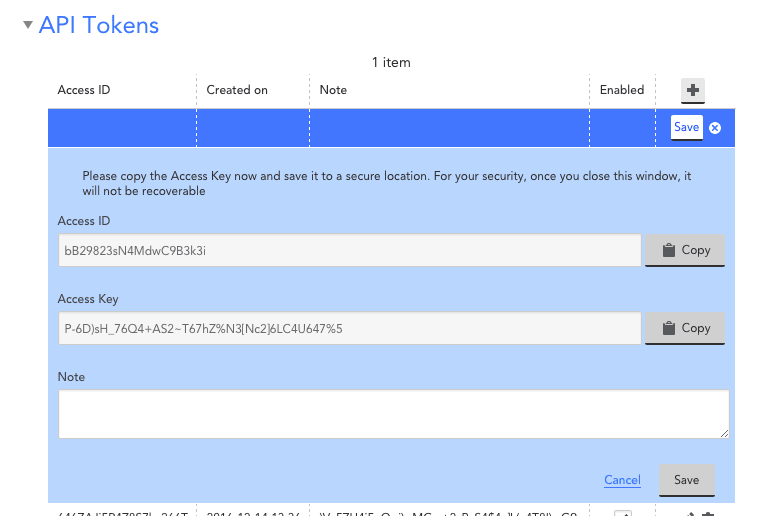

This is the authentication setup. It’s easier than it looks.
To get the AccessID and AccessKey, open the console and create a new or use an existing user. Under the API Tokens, press the + button to generate the tokens.
The company name is the portal ie, mine is ‘lmjeffwoeber.logicmonitor.com’ so my company is 'lmjeffwoeber'
