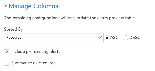

·6 years agoThat may be. Just to be sure, there's the "cleared" filter, then there's a different option below the preview for including pre-existing alerts:
Ryan_P_
OP6 years agoAlright thank you for that information did not even realize that was there. And with some of the current changes the checkbox changed to "cleared" instead of "include preexisting alerts" one. Thank you again for the help.
LM User
·6 years agoWhen setting up the report did you see the alerts in the preview? Check your filters to make sure the time range and filter include the alert time and other criteria. Also, check to see if the "Include preexisting alerts" checkbox is checked.
