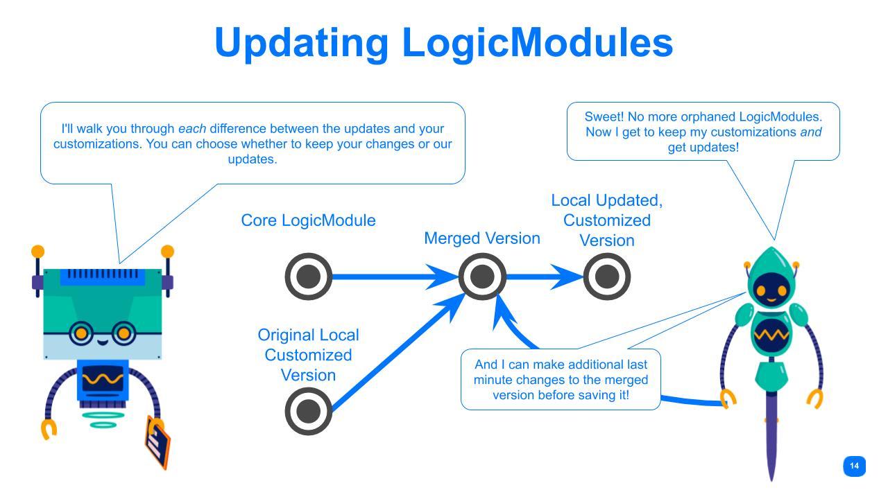

OP6 years agoThank for the info on the data sources. I didnt know they would keep customizations now, thats awesome!

·6 years agoThis is no longer the case thanks to the new LM Exchange. When downloading updates to a DataSource, it kicks off Save LogicModule Merge, which identifies the difference between your installed version and the updated version. Then, for each difference, you get to walk through choosing to keep your version of that setting or the exchange version of the setting.

I try not to edit the data sources because that means updating them from the repository will remove my changes.
So I cloned the data source and added the complex datapoints I needed to track Watt Hours
