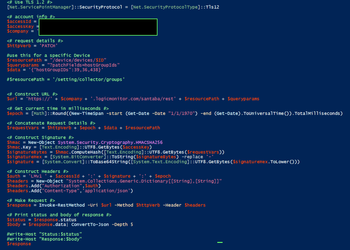

OP4 years agoJust installed Postman. Never used it before so will work through figuring that out. script I'm using is below and i was working off what is on this page Update a Device | LogicMonitor
device ID is defined in the $ID variable

That said, what does your call look like (no creds)? Are you including the payload body in the calculation of your LMv1 signature (the encrypted part of your LMv1 token)?

When I run my PATCH (using powershell btw) i get an errmsg response "Authentication Failed". using same API token i use in my GET (successfully). and I am an Administrator in our LM instance, so the Authentication Failed is really throwing me off here........

·4 years agoHere are the properties on my device. hostGroupIds is not under system properties. It's a peer to name, displayName, id, etc. 4th from the bottom here.

OP4 years agoWhere are you finding "hostGroupIds". When I get a response from one device i found "deviceGroupIds" in system properties. That is the value i was messing with. Am i looking in the wrong spot?

·4 years agoYep, @Mike Monizhas the right answer.
I just did this in Postman through the API. Make sure you do a few things:
1. Set the query parameter "fields" to "hostGroupIds"
2. Set the body to include the new overall value of hostGroupIds. In my case, the existing value was "261,260,258". I changed it to "261,260,258,262".
