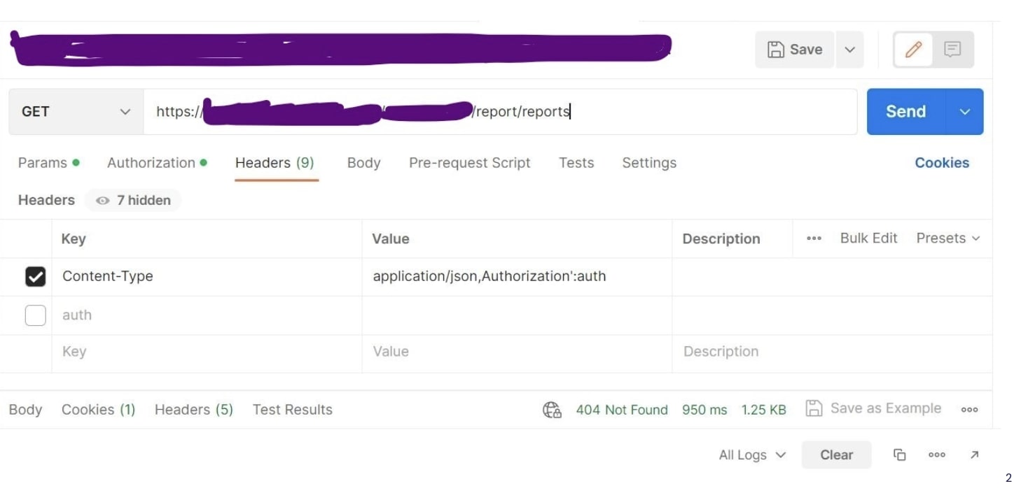

Postman is the right way to test it out. Did you follow the instructions in the link? Do that first and test that you have it working by doing a GET on /report/reports.
It’s fine that you redacted some information, but you didn’t redact your API key, which is the actual password to get into your API. You should be using the pre-request script in postman, all of which is explained in the postman setup instructions linked above.
LM User
·3 years ago
Looks like you’re not using Postman with variables. Your content-type is bad and you’re missing some stuff. Does postman work for any requests? Make sure your postman is working right.
Also, it looks like you have redacted some information, but you didn’t redact your API key.
I am getting 404 error please refer the attachment.

LM User
·3 years agoPostman is the right way to test it out. Did you follow the instructions in the link? Do that first and test that you have it working by doing a GET on /report/reports.
LM User
·3 years agoLooks like you’re not using Postman with variables. Your content-type is bad and you’re missing some stuff. Does postman work for any requests? Make sure your postman is working right.
ravikiranmn
OP3 years agoThank You
Stuart Weenig for swift reply.
