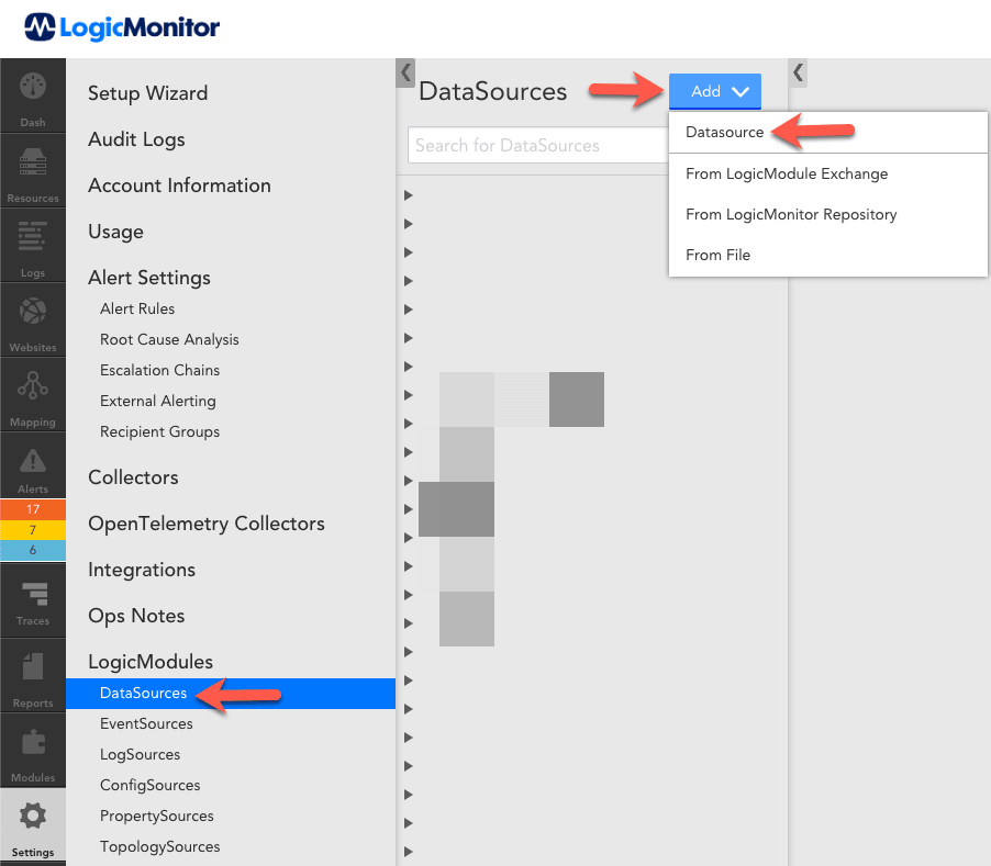

So, just to give a visual to maybe help, although you are right that it may be permission related.
On the modules page, you should see a cog in the left sidebar, it may be hidden under a set of vertical dots:
If you were to click on that cog, you are taken to the settings page, which will have the DataSource option in the sidebar. Once you click on DataSource, you have an option for Add → DataSource. This will allow you to access the UIv3 DataSource editor and add the DataSource that way:

This may be something we need to take to our product teams to understand if this functionality should be available currently. However, as a temporary solution you can still add DataSources through the settings page for DataSources.
This doc here walks through the creation of the DataSource on that page:
