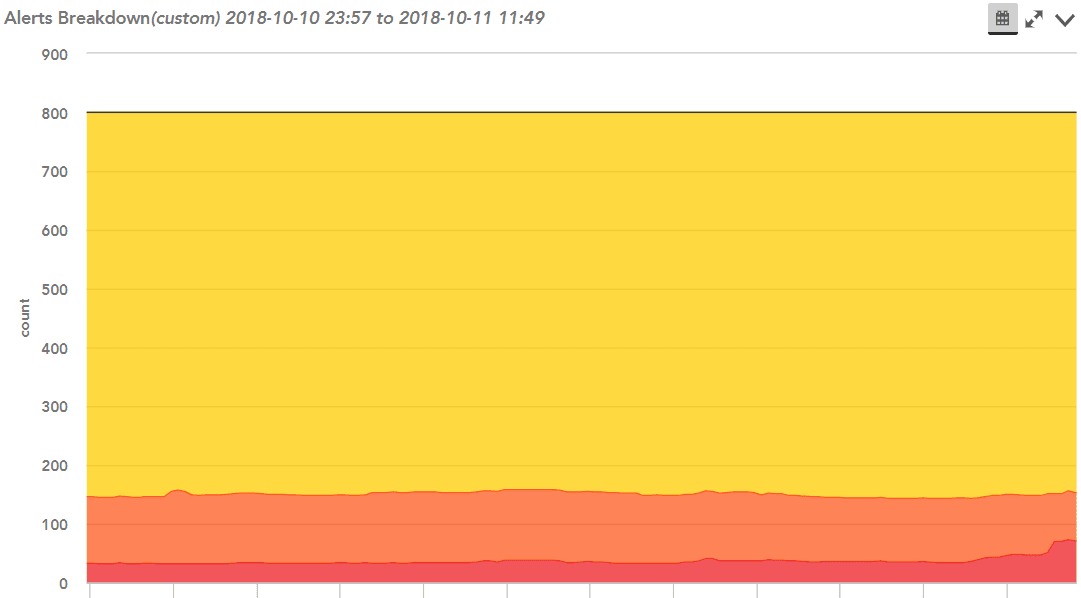

·8 years agoFound it
it's in the call to LM,
int itemsPerPage = 800

·8 years ago@Kerry DeVilbiss this is awesome. Question for y'all on this, the total alert count looks to be maxing at 800. I haven't done any troubleshooting yet to see if that's just what it's reporting, but curious if that's a limitation somewhere in the script.
