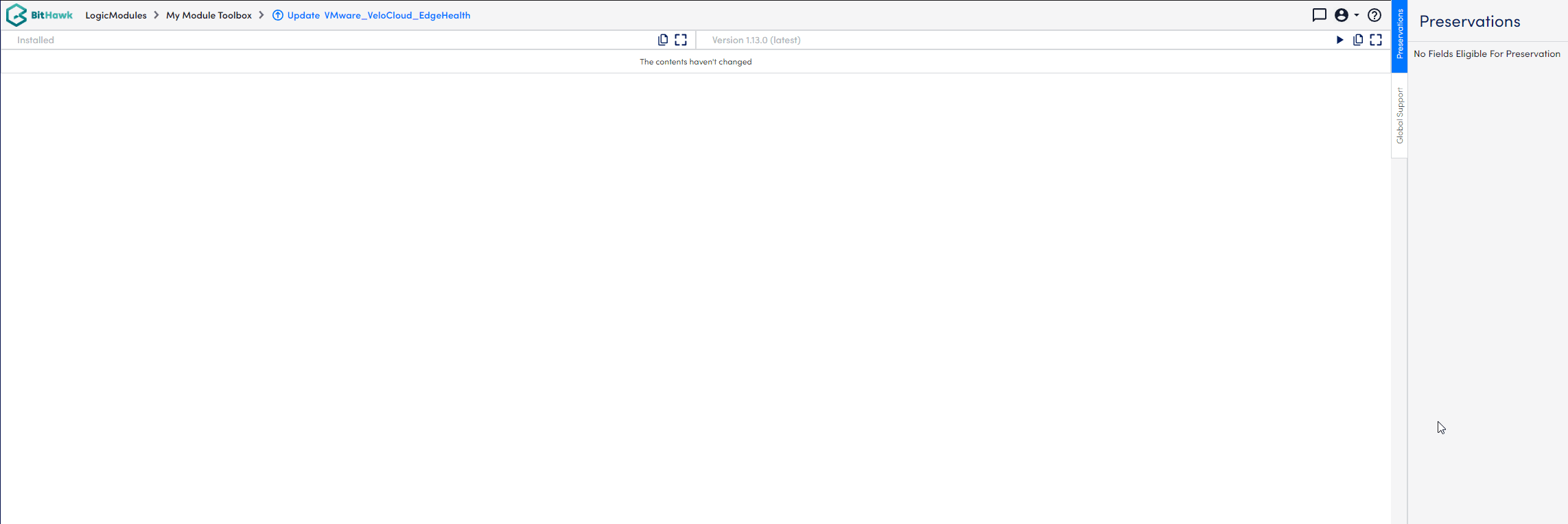

Hi Community
I wanted to install the LogicModules updates today and came across the following problem. For various DataSources, which I have already customized, I can no longer see the difference view before the update. It says "The contents haven't changed" but why should it then show me this module in the updates? Examples of DataSources are "HP_System_CPU", "SSL_Certificate_Chains", "Cisco_UCS_Sessions", "EMC_PowerMax_RDFDirector", "VMware_VeloCloud_EdgeHealth" and many more.
Do you have similar problems with UIV4? I don't think I pressed a wrong button in the difference view or something similar.

OP2 years agoI was able to check this today in the old diff view (last week I no longer had access to it?). My modules are not metadata that have been customized. Everywhere it was just the order of e.g. graph definitions or datapoints.
It makes no sense to me that this makes a difference from the old to the new view. Or as you said, that the diff engine recognizes that something has been changed but still doesn't recognize anything 😅

·2 years ago@Michael Rodrigues can give a better explanation, but in my experience, these aren’t customized modules, but modules where metadata differs between your installed version and the core (repo/toolbox/exchange) version. Something like keywords or author, or something else that you can’t modify. The diff engine that checks if there’s an overall difference checks these attributes while the diff engine that generates the diff from your screenshot doesn’t take those into consideration. So, the overall diff engine that is responsible for telling you that there’s something different is telling you that there’s something different. The diff view however, doesn’t show those differences, so it looks like they disagree with each other.
I have asked that this be fixed, but it needs to come from more customers.
Since i couldn’t just wait a few years for it to be fixed, i compared the modules myself, using my sandbox, and didn’t find any functional difference. So I imported them into my prod portal. Upon doing that, it brought in the mismatched metadata, making it match and it no longer showed as having an update.
Please ask LM to surface the differences that are causing the main diff engine to flag it as needing an update.

OP2 years agoOf course I forgot to add the screenshot
