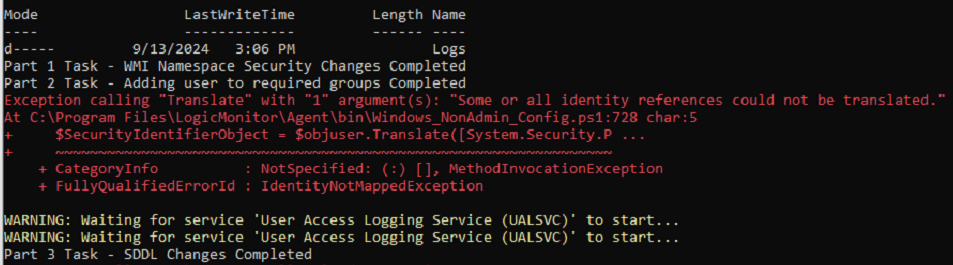

I'm working through how to implement the least privelege "Windows_NonAdmin_Config" script in 100+ environments. In at least two, the LM service account we have is the only one with enough admin credentials to change the account to non-admin. I'm testing in our own internal systems to make sure I can get it to work.
In my first go of it as both the LM Service account and using my own Admin creds in our environment, I'm getting errors:
Has anyone else seen this? I'm going to keep chipping away at it as I'd like to come up with a purely LM solution to the shift due to the scale of the effort in our MSP environment. We do have ConnectWise Automate to utilize if I can't get this working, but right now, I can't even get it going using the instructions provided directly on the VM (in a console window using 'enter-pssession 127.0.0.1 -credential (get-credential)' to get a session with admin priveleges.

OP2 years agoGot it to run without alteration. Have to figure out how to do so without human intervention to make this a usable script in our environment (100+ domains = 100+ accounts).
Based on Mike_Moniz 's findings, I made sure to use the account explicitly as entered in the "Logon as" section of the service. I'd been assuming that the script would use the collector's host's domain for the account, so had just entered the username (as the flag implies)... but it wanted the domain stated explicitly. domain\username format. I was running in powershell under the account being changed to make sure the collector would be able to make the necessary changes from "within the house." I'll most likely be stealing the script out of the agent/bin folder and altering it to run using tokens for user and pass from a propertySource script. Have it run once a day, add a test for domain admin membership and run the LM LP change code against it if it is still a domain admin. Skip it all if it is not... then add a property at the end indicating whether or not the account has DA in each client domain.

Oddly the line that is failing for you, 728, is line 711 for me, but it looks to be part of the ChangeSecurityDescriptor function. It looks like that line is attempting to look up the user on the system and get it's SID using the NTAccount.Translate(Type) function. I was able to replicate your issue when passing in a local user on a domain-joined system. Try changing this code two lines above the failure, from:
to:
NOTE! I only did a quick test of just the failing section of that script by having it skip straight to this function. The script is pretty complex and half of it is C# embedded code with DLL imports so no idea if it's doing something weird and that change causes you to be deleted from the universe. Also since your failing line number is different than mine, it might be a different version of the script. I looked at the script from a freshly installed v36.200 collector.
