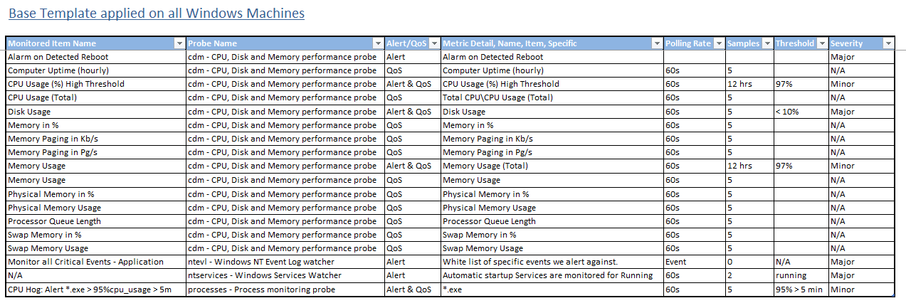

So as an MSP, we get asked all the time from client(s) and new potential new clients what'sour monitoring template for each different technology.
We needed to create an excel sheet with each different Technology and then listed each UIM probe, what it collected and if it alerted what threshold it alerted at, the time it polled, samples etc..
Example Windows Base Template:
We had an excel workbook with 30+ different technologies each on their own tab that were the mostly commonly in use and could share that with clients.
I saw that export option but that isn't going to help b/c that exports into XML. I need a csv format. I can't send an xml to client(s) and say go read that. ?

>> B/c that lists every single datapoint instance. I need just the general what would be picked up by the monitoring tool. (See pic above)
In the meantime, to summarize your needs: for each DataSource that has instances, show each datapoint's name, description, and threshold (if there is a threshold). Is that right?
>> Yes this is correct. Exactly or as similar to what's listed in the pic above.
