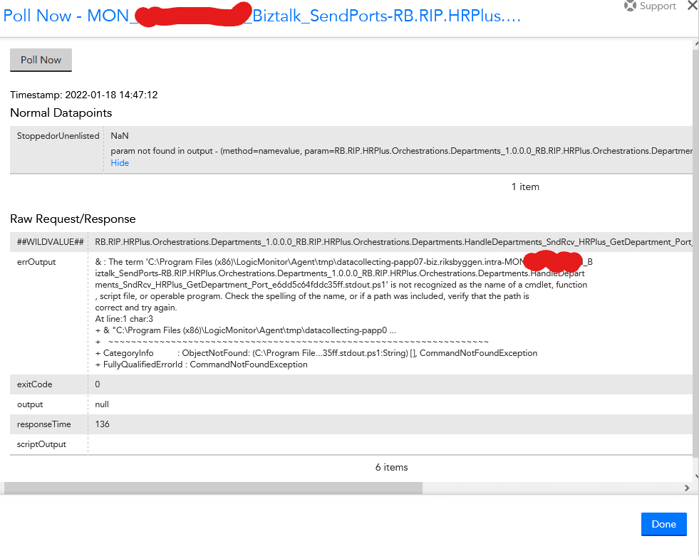

I think we have a 260 chracter length restriction problem
We are polling a biztalk cluster and looking at the receive ports, all a sudden we got a "no data" from all of them, while i was looking at this , I did a test poll and was slightly surprised by the response. Despite this clearly being an error, it exits with "0" success, which is not so helpful.
<span class="pln">collecting-papp08-biz.xxxxxxxxxx.intra-MON_xxxxxxxxxx_Biztalk_SendPorts-RB.RIP.AndraBolag.Orchestrations.Departments_1.0.0.0_RB.RIP.AndraBolag.Orchestrations.Departments.HandleDepartmentsAB_SndRcv_HRPlus_GetDepartment_Port_e6dd5c64fddc35ff.stdout.ps1
errOutput
& : The term 'C:\Program Files (x86)\LogicMonitor\Agent\tmp\datacollecting-papp07-biz.xxxxxxxxx.intra-MON_xxxxxxxxxx_B
leDepartmentsAB_SndRcv_HRPlus_GetDepartment_Port_e6dd5c64fddc35ff.stdout.ps1' is not recognized as the name of a cmdlet
, function, script file, or operable program. Check the spelling of the name, or if a path was included, verify that th
e path is correct and try again.
At line:1 char:3
+ & "C:\Program Files (x86)\LogicMonitor\Agent\tmp\datacollecting-papp0 ...
+ CategoryInfo : ObjectNotFound: (C:\Program File...35ff.stdout.ps1:String) [], CommandNotFoundException
+ FullyQualifiedErrorId : CommandNotFoundException</span>
After a bit of fiddling about , I discovered that this was because the drive + name + extension + nul has a length greater than 260 characters. This is not currently permissible ( Microsoft are working on it ) The orchestration receive ports names are automatically generated so we cannot do much about those, Any workarounds? Should I create a case with LM?

I'd focus on whether or not you need all that in the wildvalue/wildalias to uniquely identify the instance. Wildvalue/wildalias should only contain the minimum necessary to uniquely identify the instance. If you just want that information visible, consider moving it to the description of the instance instead (or instance level properties).

ok, what i did, it seems to work and it may or may not help someone else. I have no idea if it is right or wrong, I am still not convinced this script / alarm point is implemented in the smartest or most efficient way, but I am very new to LogicMonitor and it needs to work today ?( and yes, I will be getting me some proper LM training!)
The general process is this, a ps script runs on the Biztalkhost and generates a list of sendports. :-
Then we have an embedded PS active discovery script which looks like this ( the commented out sections I will come too later! )
So I am guessing it is that second parameter "$alias" that provides the name of the script that LM runs in the collector phase.
Thanks to everyone for pointers and tips. most helpful.

OP4 years agook, what i did, it seems to work and it may or may not help someone else. I have no idea if it is right or wrong, I am still not convinced this script / alarm point is implemented in the smartest or most efficient way, but I am very new to LogicMonitor and it needs to work today ? ( and yes, I will be getting me some proper LM training!)
this produces a nice long list of datapoints in LM ( fig1.png)
Then we run a collector script :-
and if we have a nice long name... the script fails.
So I slapped in a little regex to remove some duplicate data in the names :-
$regex= "RB\.RIP\.|Orchestrations\.|_e6dd5c64fddc35ff|_\d\.\d\.\d\.\d"
foreach ($sendport in $sendPorts){
$name = $sendport.Name
$alias = $sendport.Name
if (($sendport.Name.length) -gt 130 ) {
$alias = $sendport.Name -replace $regex
#write-host "$name##$name"
#This seems to be the incantation that works.
write-host "$name##$alias"

OP4 years agoyes, it is a custom job that we wrote, LM support also suggested we try and truncate the names in some way.

Based on the file name I'm guessing perhaps the ##wildvalue## or ##wildalias## the DataSource creates is too long, you may be able to modify the Auto Discover script to shorten it by only outputting the important part or even just capping the length to 200 or something like that. Might need to modify the main script also to account for that.
mark_rowlands
OP4 years agocomfirmed by LM support and no, they are not going to fix it anytime soon, suggestion was to truncate the names in the collector powershell script. I did suggest the LM developers might want to take a look at https://docs.microsoft.com/en-us/archive/blogs/jeremykuhne/net-4-6-2-and-long-paths-on-windows-10
