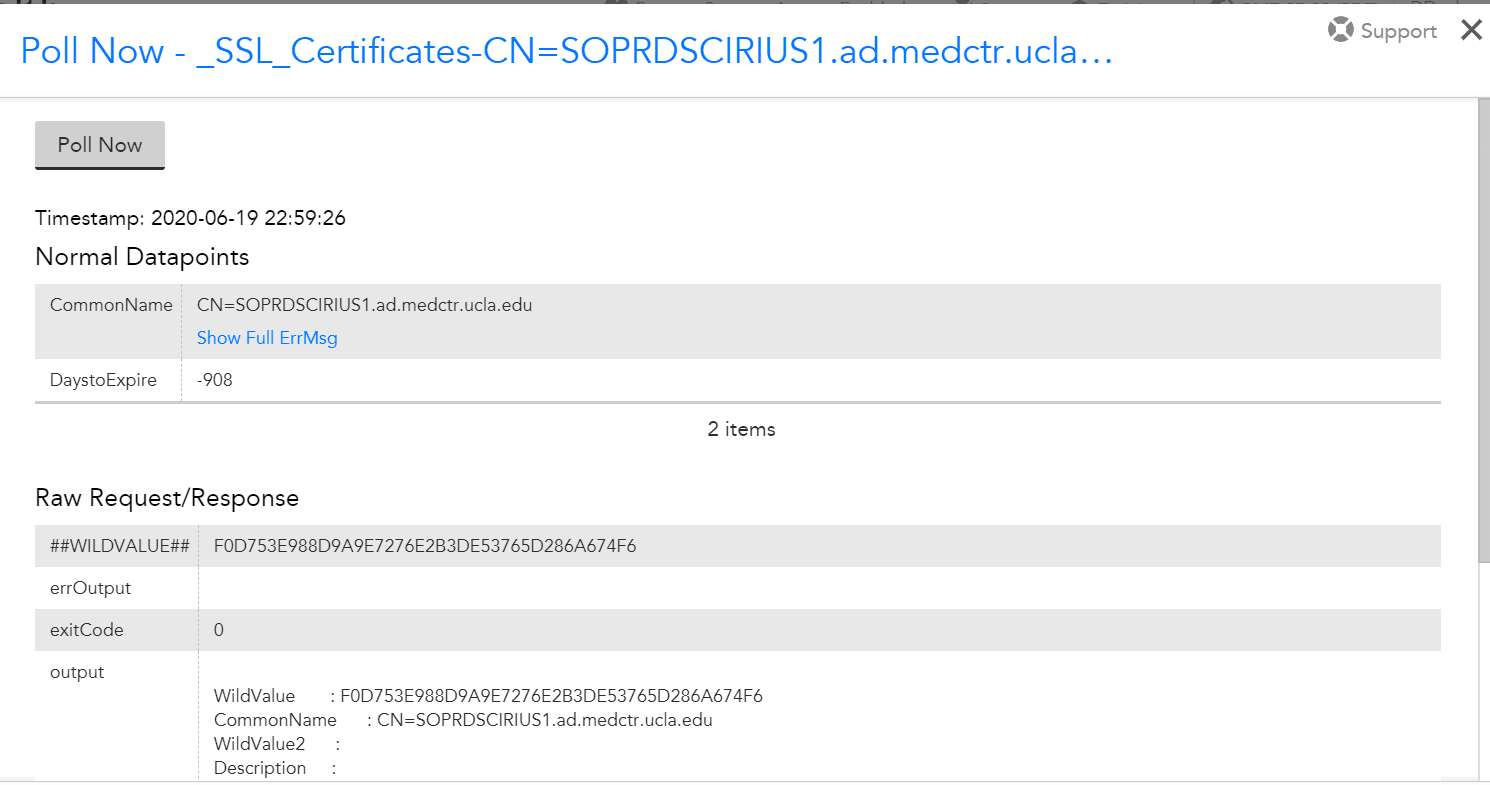

OP6 years agoHello,
The field CommonName is filled up but not with the value expected, it has the WildValue F23456... and not the CN... From the script results I thought the WildAlias was filled with the CN (see attachment) but apparently it is not strange!!!...
The DaysToExpire is filled up in the Raw Request/Response but not but does not in the Datapoint. Not sure why the "##WildValue##.DaysToExpire" is not showing the value ...
I think the datapoints are not correctly defined...
Thanks,
Dom
Dominique
OP6 years agoHello,
Some updates:
##--------------- Discovery ------------------##
$readOnly = [System.Security.Cryptography.X509Certificates.OpenFlags]"ReadOnly"
$localMachine = [System.Security.Cryptography.X509Certificates.StoreLocation]"LocalMachine"
##$store = new-object System.Security.Cryptography.X509Certificates.X509Store( "\\##SYSTEM.SYSNAME##\root", $localMachine )##
$store = new-object System.Security.Cryptography.X509Certificates.X509Store( "\\##SYSTEM.SYSNAME##\my", $localMachine )
$store.Open( $readOnly )
$store.Certificates `
| Select-Object {$_.Thumbprint + "##" + $_.Subject } `
| Format-Table -HideTableHeaders
and
##-------------- Counters --------------------##
$properties = @(
@{n='DaysUntilExpire';e={($_.NotAfter -[datetime]::Today ).Days}},
@{n='CommonName';e={"##WILDALIAS##"}}
| Where-Object {($_.Thumbprint -like "##WILDVALUE##")} `
| Select-Object $properties
with two datapoints ...
I am progressing but not yet okay... I did a poll and I have No data for CommonName and DaystoExpire but I have the information in the Raw Request/Response output so I think I have wrongly associated some fields!!!!
Thanks,
Dom

LM User
·6 years agoAre the alarms in your first screenshot coming from the right DS? Looks like that alarm is coming from "SSL Certificate Expiration". Is that the same DS you built?
The common name is stored in the instance description right? If so, it should show up under the instance description in the alarm.
