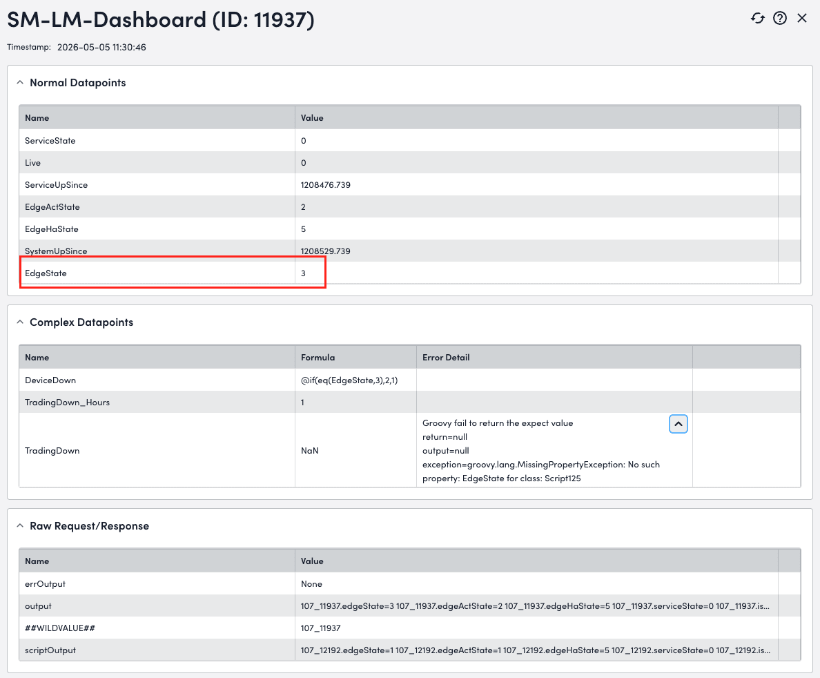

I'm using the Velocloud API module that polls a central Orchestrator platform every 5 mins and returns a number of properties for each instance that has been discovered. I need to use a complex datapoint to perform some additional post-processing based on the return value of one of the properties call "EdgeState".
I have an expression that gives me what I require which is:
if(eq(EdgeState,3),2,1)
If the value is 3, return 2 else its a 1.
I'm trying to get the equivalent functionality from within a Groovyscript, by doing the following:
def result = (EdgeState == 3) ? 2 : 1
return result
However I get an error; exception=groovy.lang.MissingPropertyException: No such property: EdgeState
I realise this is telling me that EdgeState has not been found, but I don't know what syntax to use to correctly address the value...
Here is the construct for the datapoint from the module:
Here is a screenshot from one of the instances illustrating the issue (TradingDown is the complex datapoint I am referring to):
Any help will be greatly appreciated

OP4 months ago · EditedHi all - after following up with TAC on the above, it appears this is not currently possible. To achieve this the collection script would have to be modified directly to export a new datapoint that has already had the post-processing applied. I think I have figured out a work around for my use case which is based on creating multiple complex datapoints & then using expressions to manipulate them and raise the required threshold alerts... I have raised a Feature request asking for datapoints to be made accessible to complex datapoint groovy scripts, so custom post processing can be managed easier whilst minimising the number of complex creations
