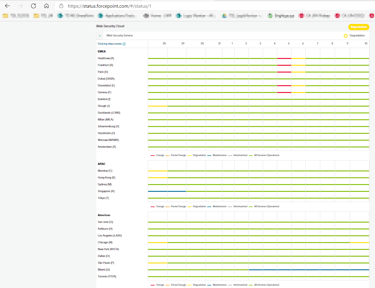

Noticed there was a datasource for status IO page but the instructions suggest looking up an App ID by appending api/v2/status.json at the end of the URL. I wasnt able to find that info for Forcepoint (https://status.forcepoint.com/#/)
Was checking to see if this was indeed on a status IO page and if the datasource would work?
The goal was to get the heath status info via Logic Monitor.

Thanks your DS and PS it seems to be working. Have a small issue I have added the DS and PS in LM and PS was able to find the key and it has discovered the instances but it cannot add all the instances in instance group. When we test the script it shows all instances. For eg. Instance Group Web Security Service shows Data centre locations but there are more data centre locations but they have not been added.
Let me know any help is appreciated.

·5 years agoIt should work with the ID 78lm3dxlst13.
I had to do some digging in Chrome dev tools to figure this out. If you're interested, I can document how I found it. Essentially, Forcepoint has a vanity URL that points to its status page hosted by StatusPage.io. The page /api/v2/status.json isn't mapped from the vanity URL, so I had to do some digging.
I'm not sure if it's a problem with my version of the DS, but I couldn't get it to work by manually setting statuspageio_key on the device. Give it a shot, and if it doesn't discover the instances after a few minutes, reply back here and I'll show you what modifications I made to my copy of the DS to get it working.
