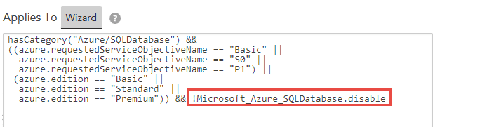

·2 years agoWe’ve solved this by a few easy steps (if I understand your goal):
While this works, this is in no way supportable on a larger scale.
Jared Meidal

·2 years agoIs this actually possible to do - adding `<dsname>.disable` as a property ?? This would be so handy.
Not currently. That’s the feed request: make it implied on all datasources. Please submit it through your portal.

·2 years agook so i can do this but we still have to modify the Applies to
Barb Ramirez
LM User
·2 years agoYou’re totally welcome to it. More than once, I’ve put in a feed that all DSs have implied logic for applies to and discovery filters.
Imagine you could exclude a DS from a device simply by adding `<dsname>.disable` as a property and not having to modify the AppliesTo. Imagine you could disable at a group level, then enable on a few devices in the group. When you combine implied logic in the appliesto/discovery filters, things could get really powerful.

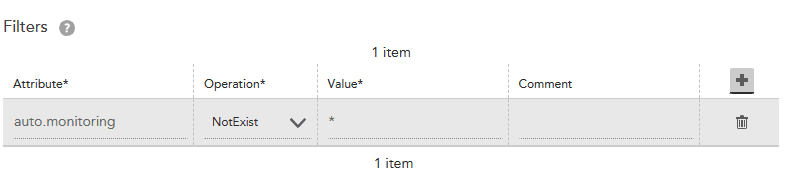

OP3 years agoI realised that I needed to put the customproperty esx.tags=true on the vCenter Server, for the Active Discovery script to return the tags on each VM. That’s working now.
I’m trying to understand how to best use the Active Discovery Filters. Ideally I want to exclude any instance that has the tag “exclude” in the “monitoring” category. This comes through in the properties as
I’ve setup the filter as follows:
Which excludes the instance that I’ve put the tag on, but also includes all other instances. It seems that, if the instance doesn’t have an “auto.monitoring” property, then it gets filtered out as well.
The following does work, but I think this will exclude an instance that has ANY value for auto.monitoring - so if a VM has other tags in the “monitoring” category then it will get filtered out.
Is there any way to set the Auto Discovery Filter so that it only returns items where “auto.monitoring” is not “exclude” but allows any that have to “auto.monitoring” property set at all?
