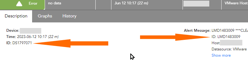

Does this frustrate anyone else?
The alert id isn’t the same as the alert id. No attempt is even made to explain the different IDs:

OP3 years agoYep, we’ve understood that for a while. One frustrating thing is that LM obviously knows how to bundle alerts together, as evidenced by the IDs involved. However, for years they haven’t had the ability to come out with an occurrence count per alert or used occurrence count to dictate opening/clearing of alerts.

The LMD number (or LME, or LMS etc. depending on the alert type) is what we (Panoramic Data Limited) calls the “Problem Signature” and relates to the INSTANCE/DATAPOINT tuple. For example “Downlink throughput on Bandwidth Router 5’s GE1/0 interface”.
This can reliably be used as the identifier for the Incident. That way, if the bandwidth keeps spiking, you don’t keep opening new tickets, you just update the old one.
The DS (etc.) id is unique to the alert NOTIFICATION and will not be repeated. This can be used to tag the Comment that you add to the ticket, each time you get a bandwidth spike.

OP3 years agoWe actually don’t pass directly to our ticketing system, so the external ticketid token is basically useless. If we could use the API to come back in and set the externalticketid on an alert, that would be awesome. As it is, we currently just modify the note on the alert to contain the real external ticket id.
LM User
OP3 years agoYeah, I knew about the differences. Just two frustrations: 1) if there’s a different ID for the recurrence, why can’t there be a recurrence count and bundling of alerts by the LMx ID (and alerting based on recurrence count). 2) Did you know that the tokens are swapped? ##ALERTID## has the DS alert number and ##INTERNALID## has the LMx ID?

·3 years agoYeah. The LMx# ID is tied to the specific device datasource instance that is alerting. So an alert for Server01’s C: drive free space will always have the same LMx# alert id each time. Even for alerts that occur years apart. The 3rd letter will depends on the alert type. D=device, S=website, A=Collector, etc.
The DS# ID is tied to the specific situation and time. So for example a warning alert that occurred at 1am. This ID changes although if the alert situation changes, for example if the alert changing from warning to error then the ID changes. I think because the system kinda clears the warning and then alerts and error, but will pass previous alert state.
I guessing this is because it’s useful for the GUI show alerts the way it does. It does mean that neither ID is useful for linking to tickets. The LMx# id is too long-term and the DS# is too short. You kinda have to either let LM to the tracking via ##EXTERNALTICKETID## or setup the ticketing/integration system o have complex logic to track alerts and keep it’s own state of each alert and it’s ticket.
