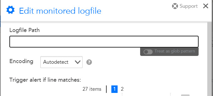

OP3 years agohi , i have the follwing path
To read log file using event source can you please tell me how to fill the logfielpath using above path
LM User

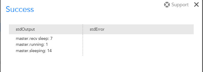

·3 years agoYeah, you should avoid the space. You can do a .replaceAll(“ “,””) on that portion of the string to make sure it doesn’t have any spaces in it.
manthena2020
OP3 years agoi am have space in one of the output ( recv sleep). i have issue to capture that datapoint. when i give space its not pulling data
can you please tell me . Thanks
manthena2020
OP3 years agoThanks bro problem solved. I have used ‘-’ instead of : . problem solved
Thanks
Bye bro

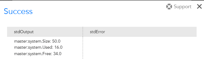

·3 years agoYour output must change since `:` is not allowed in the wildvalue. This is why I suggested the script updates.
If your wildvalue were “BTS_PROD_system” your output would be “BTS_PROD_system.Size: 21260” so your datapoint key for Size would be `##WILDVALUE##.Size`.

LM User
·3 years agoOh, I misunderstood. I thought you said the data was not polling.
manthena2020
OP3 years agoAs i got my out put as required, cant’ i poll data with the old one?
LM User

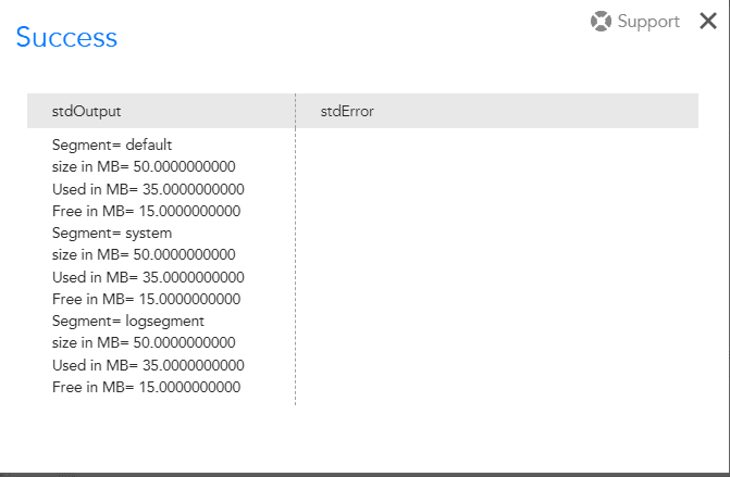

·3 years agoI suggest the following simpler version of your discovery script:
To get the same names into your collection script, you’d just repeat what you’ve already done in your discovery script, just output the data instead of just the names. This requires changing back to BATCHSCRIPT, since you’d be outputting all the data with one run of your collection script. I’m making a lot of guesses here since I don’t really understand your data. You may need to adjust this so that things match up.
Notice how the only real difference between the two is what gets output for each segment in the `while (segmentRs.next()) loop. In discovery, you output the instance naming details. In collection you output the wildvalue, plus the datapoint name, plus the value.

So, instead of running this query in your discovery:
Is there a query you can run that would return the sysdatabase name in the first column and the segment in the second?
manthena2020
OP3 years agoactually, Iam think of to add segment as discovery. any idea of that
LM User
·3 years agoYou should make this a “script”, since your collection script is designed to only poll one instance’s worth of data.
In your collection script, your datapoint keys should not have spaces in them, so I’d update line 28 in your collection script to this:
You’ll also need to figure out a way to transform the “Segment” into a number since the collection script can only provide numbers to the DataSource. You could modify your discovery script to add the segment as part of the instance definition, either the description or an instance level property. I’d work on getting your collection working before attempting that.
