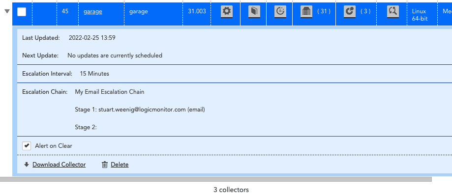

·4 years agoFor catastrophic failures of a Collector, it's pretty easy to recover, assuming you have a place where you can reinstall the Collector. Just get your Collector VM back up and running, then go to LM and download the Collector installer for that Collector:
Run the installer and it'll reestablish connection to LM platform, platform will reassign devices back to it (assuming you have failover/ABCG setup) and it'll start running. The Collector itself is a very, very smart goldfish. It does very complex things, but doesn't have a "memory" of its own. It's just a proxy for the platform.
