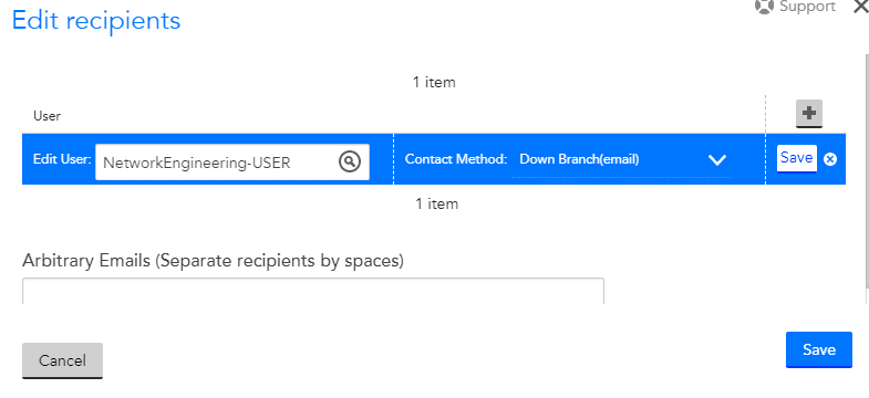

I started with trying to make a Alert Rule for down branches with Host Status. Originally the down branch rule based on ping was the top rule (5) so I copied the setup of that rule and made this rule at 4. The only difference is Instance = HostStatus* (was Ping*) and Datapoint = idleInterval* (was PingLossPercent*). However, the emails in the ticket still have the ping info in them, so I'm not sure if they are actually hitting and using the rule as intended.
