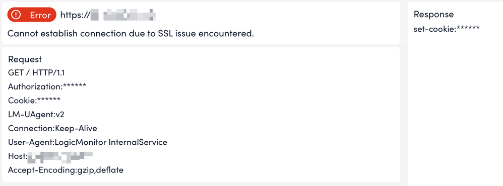

I have some https website tests that are failing because the Root and Intermediate CA certificates are not in the collector trust store.
I have added the certificates into /etc/ssl/certs and ran sudo update-ca-certificates.
openssl s_client connection now verifies the certificate chain, however the website test still fails with the same error.
does the collector use a different trust store to the standard package installed to the Ubuntu 22.04 OS?

Then the website check step failing:
One other minor frustration is in the debug runner, !opssl is listed as a valid command, however when trying to run it, it says unknown debug command, really not all that useful so I can to connect to the customer environment and directly ssh to the collectors to even begin troubleshooting because there was no real useful information returned in the UI.

OP1 year agoJust to close this one down, it seems there is an issue with TLS negotiation, so it's a 3rd party issue.
LM support fed the following back:
