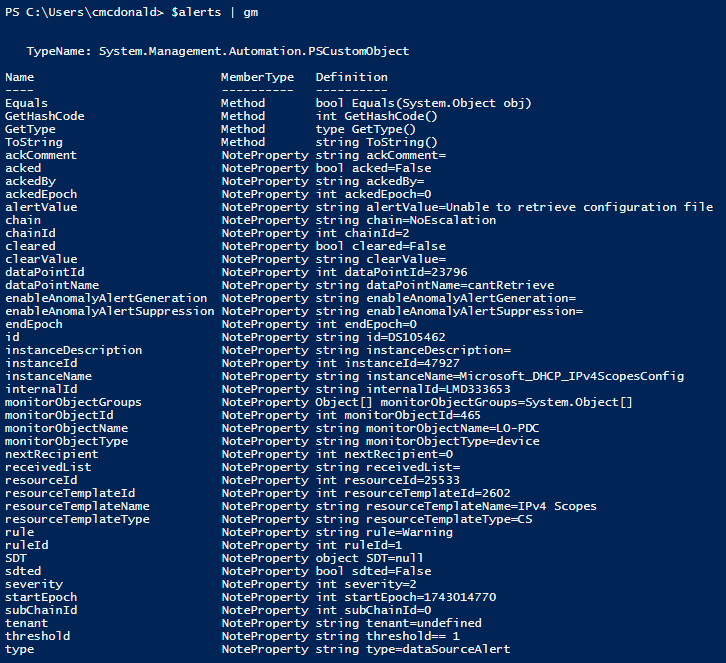

OP1 year agoStill no return. Here's the full (nearly) RestAPI URL I'm using:
I get a full return of alerts, filter to ones that would have ticketed in connectwise and should have an EXTERNALTICKETID value present. There is no extra property returned in any of them

·1 year agoThat's odd. I've just tested with the following URL and I'm getting a customColumns object with ##EXTERNALTICKETID## in it. I'm also getting an alertExternalTicketUrl object that has the Service Now Incident ID and a link to the incident.
This is the URL I'm using.
https://xxxx.logicmonitor.com/santaba/rest/alert/alerts?customColumns=%23%23EXTERNALTICKETID%23%23&size=500&offset=0&filter=startEpoch>:1751907790
Are you passing in the X-Version=3 header? I was just catching up on another thread where that turned out to be the issue, prevented the API returning the full list of properties.

OP1 year agoStill no return for that property

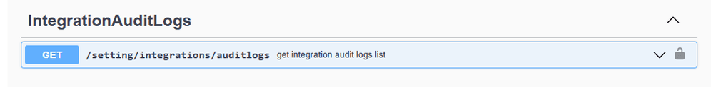

OP1 year agoFor what I'm currently trying to accomplish... this working would help as well:
It fails... have to get them from the interface directly and export to CSV... also doesn't show the externalticketid in the output, but does in the interface. Only if you click into each though... so no way to see that data in bulk currently to evaluate behavior of the integration effectively.
