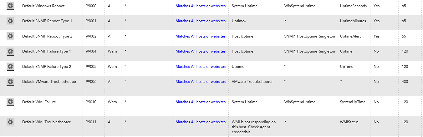

mnagel
·6 years agoFWIW, here are our catchall rules for those and similar items.
mnagel
·6 years agoWe have standard rules for this that rely on the no-data alert for the uptime datapoint, which otherwise has no alert thresholds. Finding which datapoint is appropriate is harder than it ought to be and I agree a dedicated troubleshooter DS would greatly simplify things. Right now we have several alert rules per client to capture the problem adequately.
