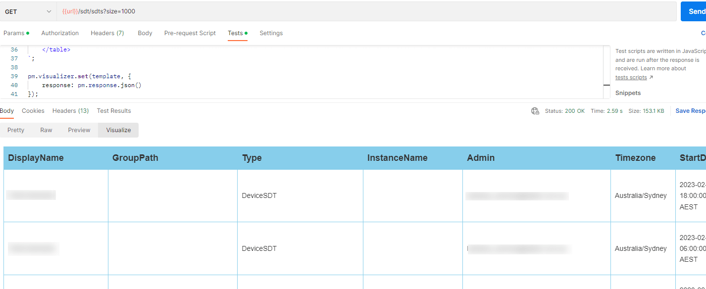

Barb Ramirez
·3 years agoAs a followup on this thread. The script was nearly perfect except i wasnt able to get the instance sdt quiet right. In the end i use postman visualize. You end up with a nice table.
this is the script in tests
var template = `
<style type="text/css">
.tftable {font-size:14px;color:#333333;width:100%;border-width: 1px;border-color: #87ceeb;border-collapse: collapse;}
.tftable th {font-size:18px;background-color:#87ceeb;border-width: 1px;padding: 8px;border-style: solid;border-color: #87ceeb;text-align:left;}
.tftable tr {background-color:#ffffff;}
.tftable td {font-size:14px;border-width: 1px;padding: 8px;border-style: solid;border-color: #87ceeb;}
.tftable tr:hover {background-color:#e0ffff;}
</style>
<table class="tftable" border="1">
<tr>
<th>DisplayName</th>
<th>GroupPath</th>
<th>Type</th>
<th>InstanceName</th>
<th>Admin</th>
<th>Timezone</th>
<th>StartDate</th>
<th>EndDate</th>
<th>Comment</th>
</tr>
{{#each response.data.items}}
<tr id=row_{{@key}} onClick="handleClick(this.id)">
<td id={{@key}}>{{deviceDisplayName}}</td>
<td>{{deviceGroupFullPath}}</td>
<td>{{type}}</td>
<td>{{dataSourceInstanceName}}</td>
<td>{{admin}}</td>
<td>{{timezone}}</td>
<td>{{startDateTimeOnLocal}}</td>
<td>{{endDateTimeOnLocal}}</td>
<td>{{comment}}</td>
</tr>
{{/each}}
</table>
pm.visualizer.set(template, {
response: pm.response.json()
This is what the table looks like
