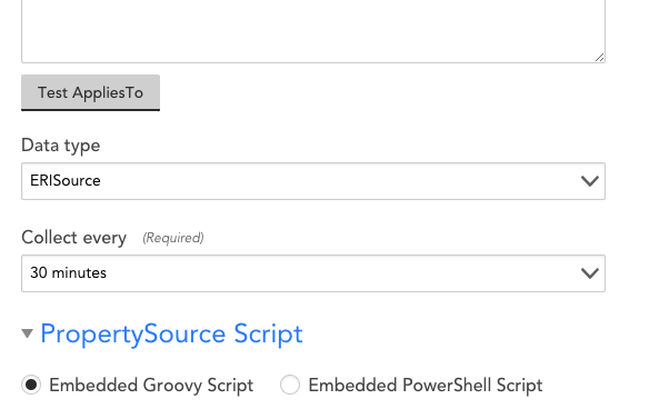

LM User
·5 years ago1. In this case, i'm putting instances on a map as vertices. But, it could just as well be devices themselves that are already in monitoring. To set the ERI on a device, all you need to do is create a PropertySource where the data type is set to "ERI Source" and have the PS output in the corresponding format. Each device and/or instance that you want to show up on a topology map needs to have its own ERI.
2. The datasource, in this case, only exists to create the instances with their corresponding ERIs. You don't have to have a DataSource at all if the only vertices you want on the map are devices.
3. For RCA, you would just help LM know which is the root of the depency tree by specifying one of the vertex devices as the entry point.

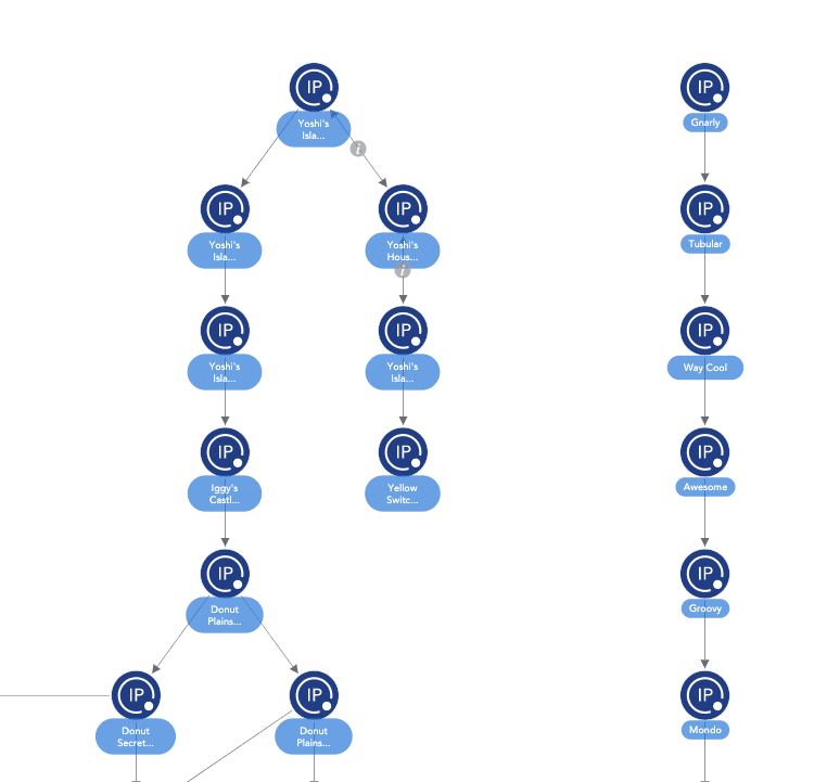

LM User
·5 years agoOk, this example builds everything from the ground up. First, a DataSource discovers instances and as the instances are discovered, the predef.externalResourceID and predef.externalResourceType are set. Each world in Super Mario World is created as an instance. The ERI for this instance is "Chocolate_Fortress" and the type is "SMWExit". This gets the "nodes" for your topology. Now you need to discover the "edges"/relationships between those.
TopologySources discover the relationships/edges. In this case, the TS output looks like this. Notice that this is a JSON formatted list of edges, where each edge specifies two nodes' ERIs and the type of connection between the two nodes.
Does this help?

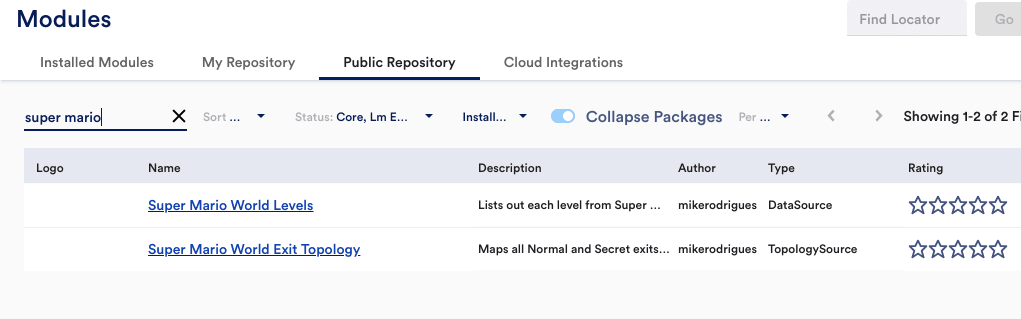

LM User
·5 years agoSorry, it just ended. You can view the replay here:
/topic/7124-2021-02-24-us-office-hours/You can also register for any of the upcoming Office Hours where you can ask your questions live.
You can find the Super Mario DS and TS that I reference by searching "Super Mario" in the Exchange Public Repository:

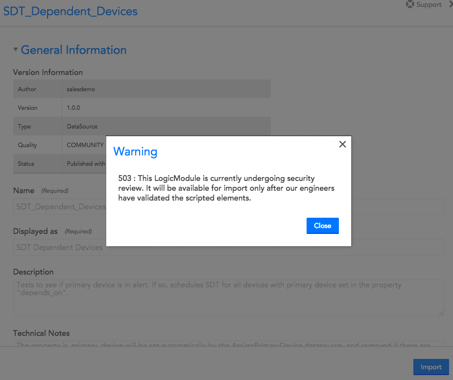

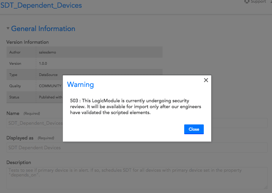

Matt631
·6 years agoThese Exchange codes dont work anymore. Getting an error about it being a private repo, Was this data-source pulled?

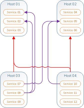

·8 years agoDefinitely a step in the right direction for LM.. now we just need to be able to use this for stuff that goes down but doesn't have an SDT lol... I assume the same logic can be applied but that involves deeper changes than data sources :)/emoticons/smile@2x.png 2x" title=":)" width="20">
I may have missed it but if it hasn't been requested, besides host dependencies, we should have service dependencies. There should also be multiple dependencies.
* Host 03 depends on Host01
* Host 04 depends on Host01 AND/OR Host02
-- (and) don't alert Host04(and services) if Host01 and/or Host02 are down.
-- ( or) don't alert on Host04 if just Host01 or Host02 are down.
* Service07 depends on Service05
* Service10 depends on Service05
* Service08 depends on Service01 AND/OR Service02
-- (and) don't alert on service 08 if Serviec01 and/or Service02 are down.
-- ( or) don't alert on service08 if just Service01 or Service02 are down.
and the list could go on with multiple scenarios...
* Service09 depends on Host 01
* Service12 depends on Host 01 AND/OR Host02
* Host03 depends on Serivce04
* Host03 depends on Service02 AND/OR Service06

·8 years agoThis will surely help a lot of customers, thank you for that. You cannot add this at the moment - the import throws an error - any idea when it will be available (or similar functionality)?
503 : This LogicModule is currently undergoing security review. It will be available for import only after our engineers have validated the scripted elements.
Steve_Francis
·8 years agoAgree - this has taken way too long to get into the product officially. (It is in the works, but as Mike said, is at least 6 months away. We're working on improving our processes and efficiencies, too...)
In the interim, these two datasources available from the registry with these locators can achieve dependencies on a device level. Feedback appreciated!
SDT_Dependent_Devices: locator 24KKNG
SDT_Assign_Primary_For_Dependencies: locator NFTHXG

LJ_Bryson
·9 years agoAnother aspect that is often missed: If the parent is checked every 60 seconds, and the child goes offline, check the parent-path prior to alerting on the child. I believe that Nagios works this way, but Zabbix does not (and it is a problem in Zabbix).
Also, with respect to multiple parent dependencies, this is primarily for alerting -- not for monitoring. In other words, if a router goes down, only alert on the router (not the 300 hosts behind it). But, still show the 300 hosts as offline/unavailable (perhaps gray, not red?).
Finally, device dependencies alone are not the end -- service dependencies are needed. ie:
if host X is not pingable, then don't alert on the 30 other checks (including web checks) that are running on that host -- perhaps bundle the dependent alerts in the same 1 email as "affected dependent services." Likewise, one MySQL goes down with 10 apache instances pointing at it for some web app -- alert on the DB, and include the list of other affected httpds in the same alert (with most critical first).
This would be even more powerful than Nagios.
